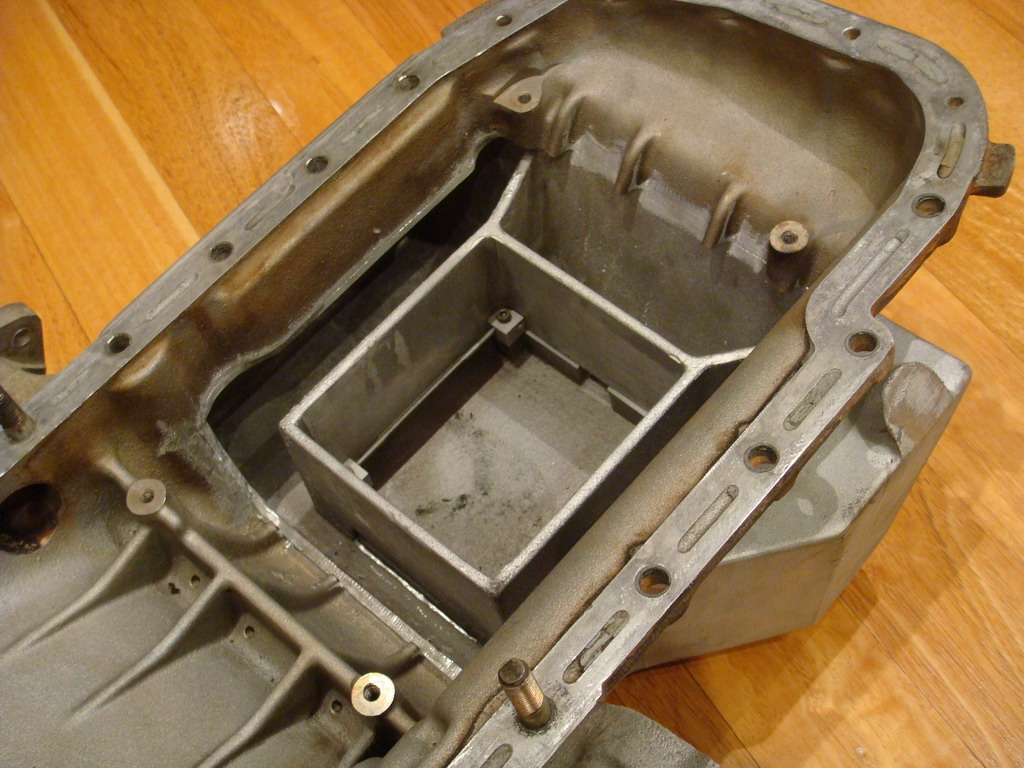

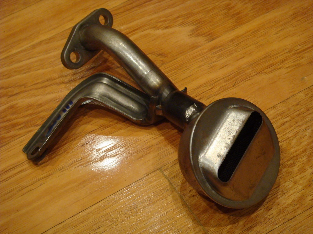

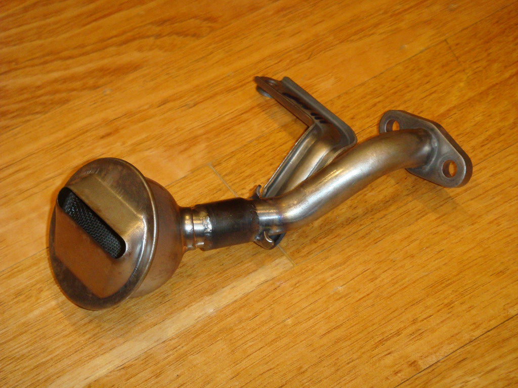

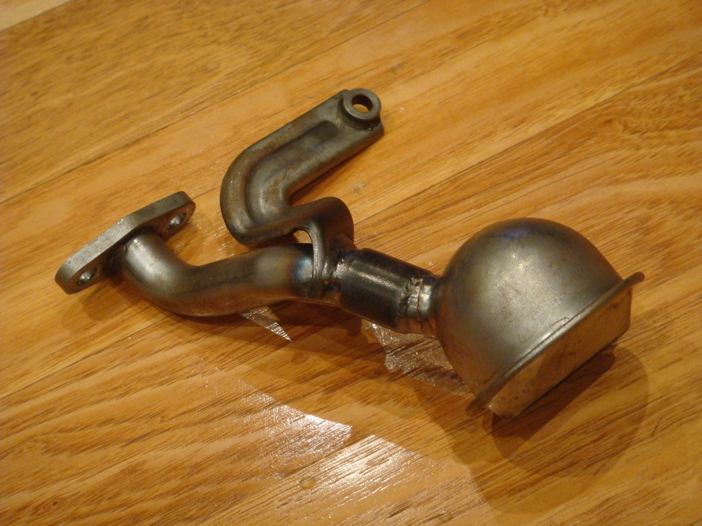

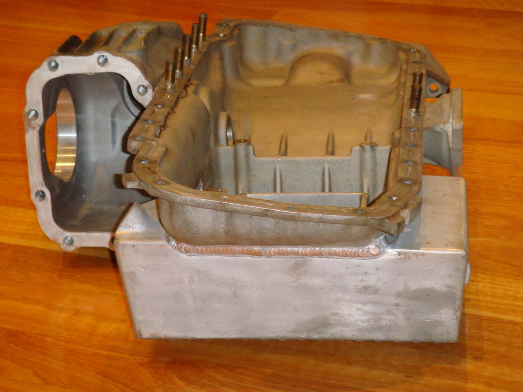

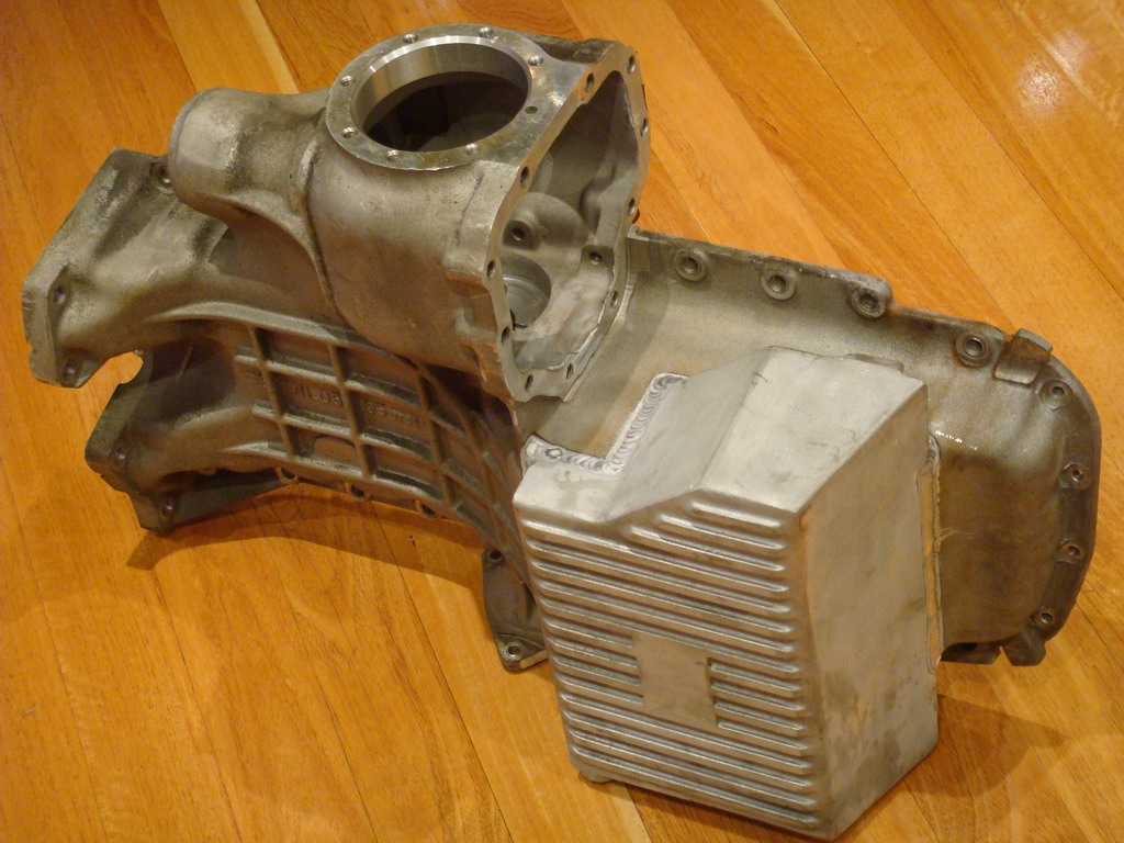

Its a time consuming job to work out the mounting and cutting out the sump to fit it but good news its quite good quality cast alloy so it welded up a treat. Recomend that you bolt the sump to and engine block while its welded and let it cool before removing it so it dont warp. Mine came out perfectly no twisting or leaks yet
https://www.sau.com.au/forums/topic/216331-sump-extension/#findComment-3822096
Here are some pics of my HiOctane sump welded up.
No pics of it mounted as yet!
