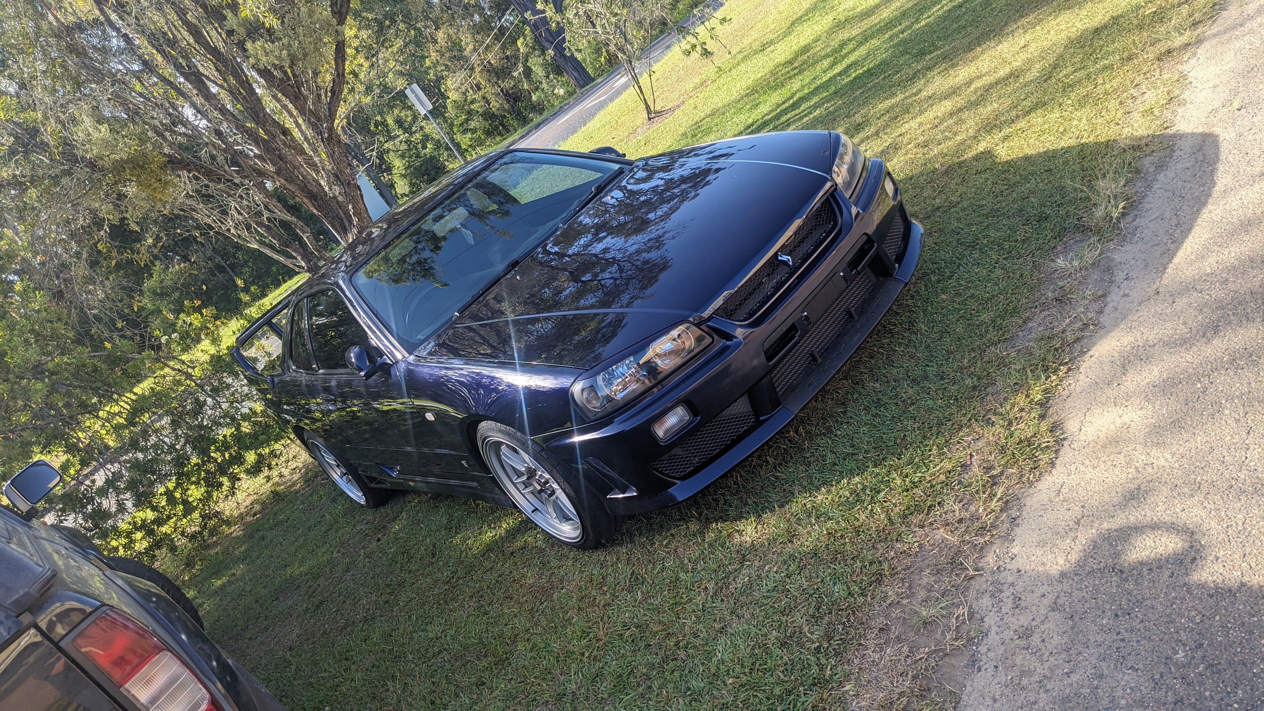

Got her home safely. Just have a few more things to fiddle around with and change but I'm very very happy with the end result and I'd like to thank Dose Pipe (NHB automotive) for taking so much of his not existent spare time to talk me through so much shit I honestly owe this man my car. MK raceworks (Matt) Extremely talented, cool, kind bloke did above and beyond with all the fab work and resolved all and any issues without a break of sweat. DVS Tuning (Jez) For being patient with me for 7 years endlessly talking about getting the car there eventually and then having the patience to fit me in last minute you sir are a legend. -

Ended up completely forgetting to keep tabs on what's been happening so 10 months down the track and with much guidance thanks to Dose Pipe the semi finished dbw build ended with 300rwkw flex tuned on E85. Here's some photo spamming. -
