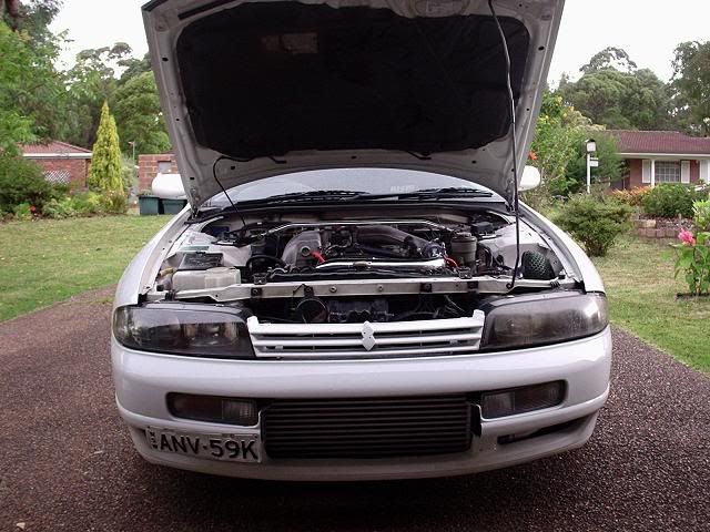

To compare how low you pipework is, refer to pic below:
NOTE: My fmic is not a Hybrid kit, but it should look very similar to this as both my mates' kits are.

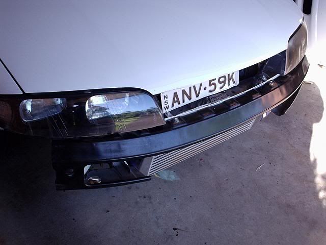

i did a hybrid FMIC on my other white R33 i used to own.... what a bitch of a job.... shattered a 9" cutting through the front bar support and just getting the right cut out for the cooler to sit in, then cutting the fire wall, playing with the front bar etc etc etc... yer well it was my first go at anything like it and i got it in the end.... wasnt a TO bad job... bar was a little dodgy but hey what can ya do..
heres a couple of pics from it..
Hey al, ,my bumper now looks very similar to yuors after having it trimmed/welded professionally:), my cooler sits behind the reo bar, so i should have more than anough clearence for the type m front no (no further trimming) is this correct.And will the healdights/tailights need trimming?
Osiris....i trimmed my reo in the same manner as you, still keeping the main support intact, think it works very welll:)
