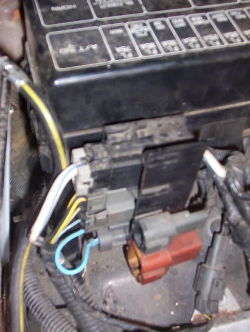

Auto wiring is easy inhibiter is on (telling your computer not to start cause you are in drive) there are two wires by the fuse box that need to be bridged
inhibiter

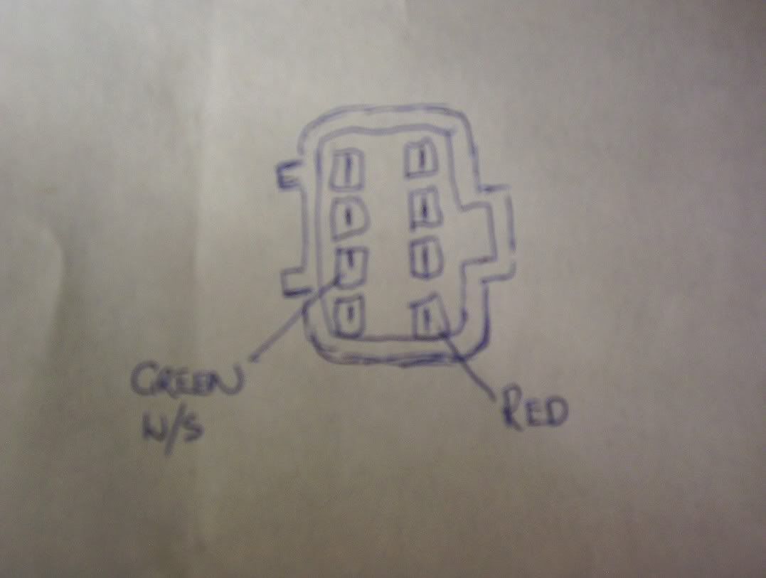

My reverse wire colours were (Black and Green but still in the same locations as the image)
reverse

Just a quick question - I need to plug up my reverse sensor. I know where it is on the gearbox... where do the wires lead to from there? Anyone know which loom/colour wires etc go back to the ECU? (i'd rather not have to re-wire it to the ECU but splice it into the loom where it should go)..

I connected up my reverse sensor to the red and green w/stripe near the fusebox.. But it kind of works the opposite to what you'd expect.. In all other gears it beeps/reverse lights go on, but in reverse all goes off!
If I bridge the red (12v) and green white/stripe on the fusebox end it goes into reverse mode properly though.
Anybody help?

Ended up using a n/c 12v relay .. If anybody is having problems, refer to this... All is sweet now.
http://www.skylinesaustralia.com/forums/in...howtopic=117731
Maybe it's just because my manual loom was cut on the gearbox, and it contains an inbuilt relay or something in the loom a bit further up? Anyhow, I don't care why really now.. just that it is now working as it should.
My reverse sensor (back of gearbox) basically just had two wires coming out of it.. a green, and green/orange stripey.
