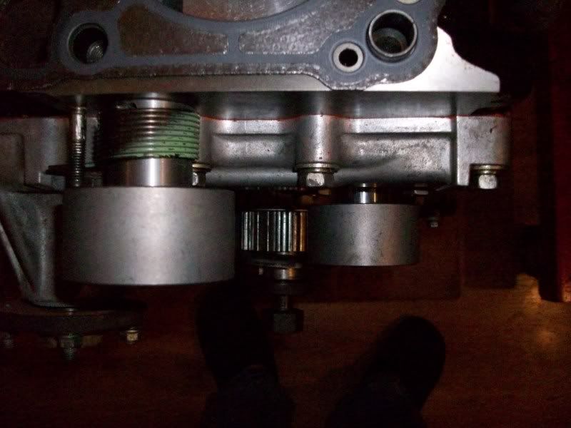

thanks for the heads up on the plate, ( proengins)
well had a go at making a wedge, first attempt nearly lost my finger, with the grinder.
but got there in the end, god 2mm one side 10mm the other side then drill out the center to fit over the thread.
but all on now and straight, all gaps the same to water pump studs 4mm, so well chuffed.
piccy
you cant use any other engine mount dave, because as it is there's 2 parts of fook all clearance between the bottom of the diff and the cross member. i posted a pic in here somewhere showing how close it sits
so, rd28 engine mounts solve the bonnet clearance issue? or is there something else? ive tried reading it all but no definative answer.
if u are enquiring about an rb30 in a gtr, u need to use the same mounts. u can slot the mount holes but not recommended due to lack of clearance
