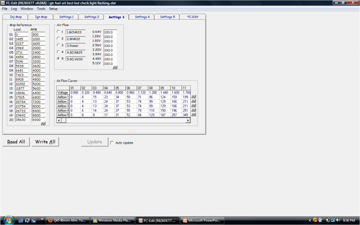

hi i having the same problem when using 2 z32 AFM with a GTX3582R
Can some one tell me were the AFM voltage ramp is????
Edited by MJTru
welcome to 2006
the voltage ramp is the range of numbers on the bottom right of datalogit
ie each airflow meter optoin (1 to 5) has its own unique voltage scale ramp
i dont think editing the voltage ramp will fix car running like ass because the afm is too close to the turbo snout
usually its reversion that makes it drive like ass and usually putting a dirty big bend in the ducting before the afm fixes it
