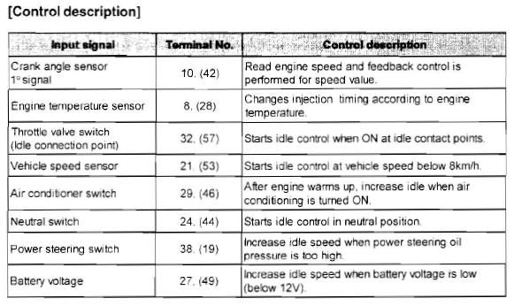

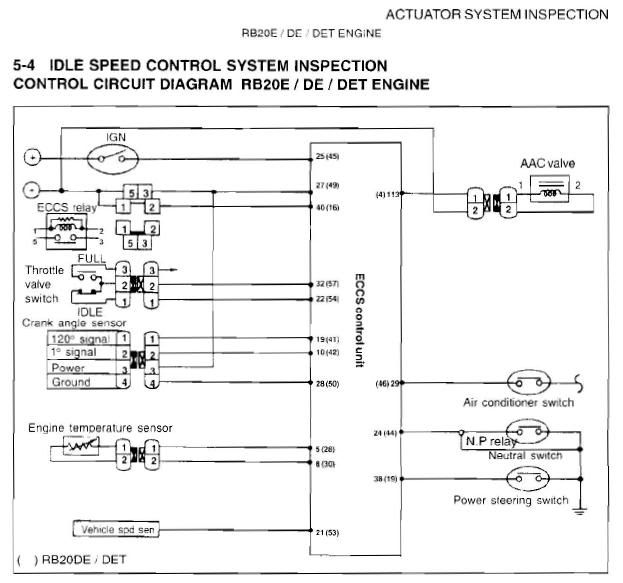

also, if you're having problems with it, i have the relavent sections on how to diagnose problems with aac valves from when someone else asked this question if they're any use...

hope this helps, cheers
yep you just take off the hoses connected to it, and those 4 bolts,
someone posted a very detailed thread on how to clean your aac a week or two ago, have a search for it, but it was very thorough
