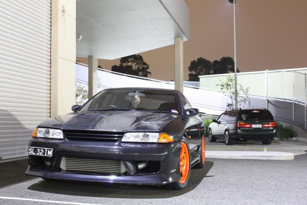

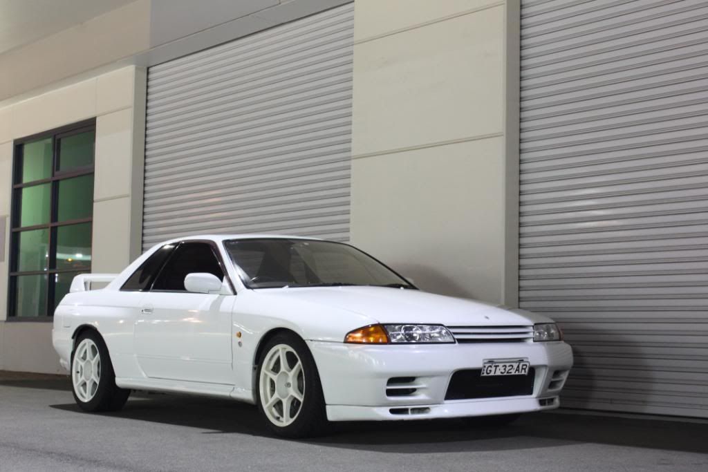

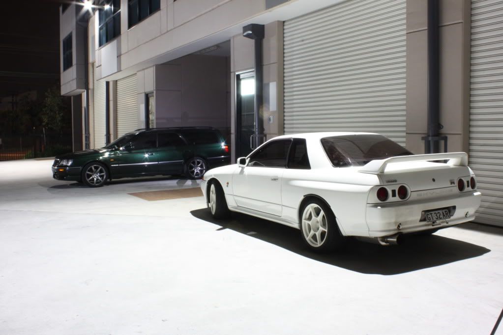

little over exposed but good start. I can see your ghost in the last pic :D
Yeah, my ghost appears in this one, but the one I took after this was MEGA over-exposed. I might try and edit that one in PP and see what results I get, then post that up.

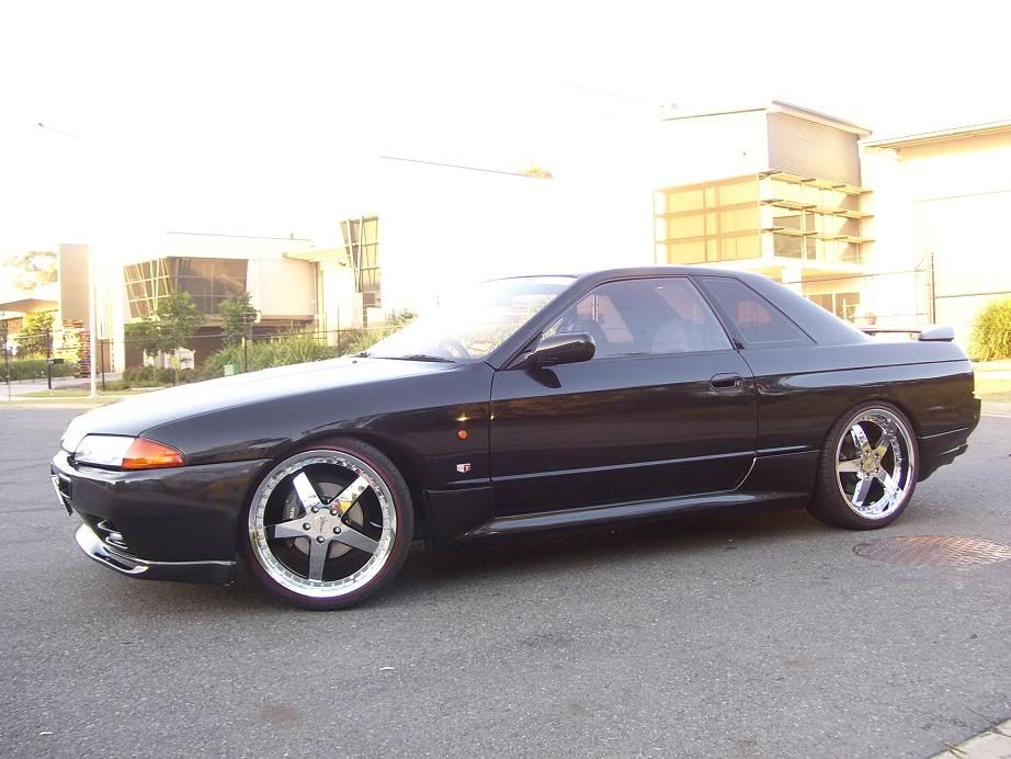

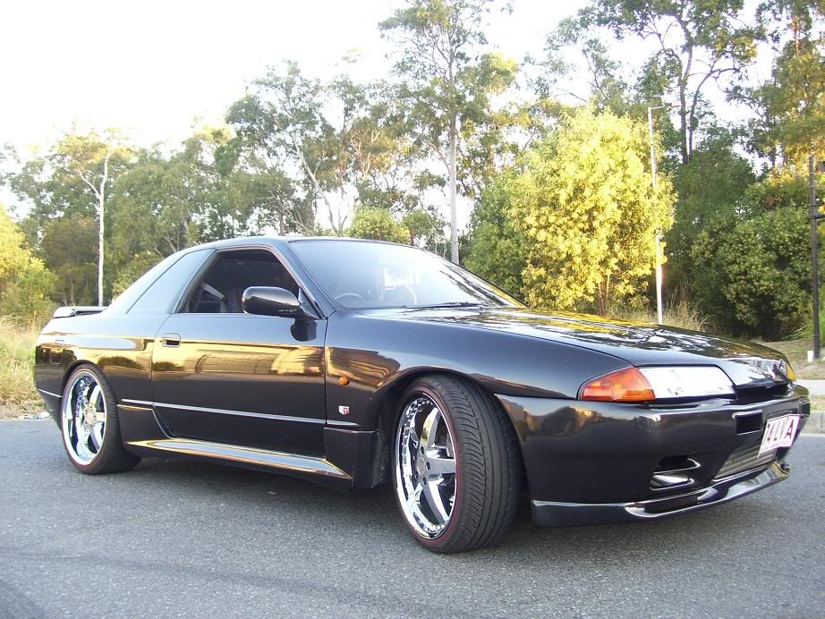

what sizes are those rims, and what did they set you back?
I can't rmb the exact specs but I'm quite certain it was 18 x 9.5 with +20 offset, running 265s all around.
www.jdmconcept.com.au :D
... yeah some bloody sweet 32s on here
