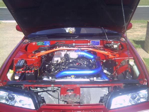

Some of the stuff the PDR guys in the states pull is amazing too. Instead of drilling a hole. They crank some insane tension into it. I actually DIY built a pulling bar myself that I used to pull the Subarus front end out with. About an hour's work, a bit of 30mm *3mm shs, and a piece of 5mm thick plate. Worked great! But I vote replace it with a GTR rad support. And not going to lie, I'll laugh if a GTR rad support doesn't fit a GTt...
Sorry, that was with regards to the rather pretzeled corner of the reo bar. It's in such a state over the years that drilling a hole is probably preferable to bothering to unbolt the thing
No need to drill any holes. There's plenty of access to reach through and behind all of that steel to "push" from behind with a pulling action on the slide hammer. There's all sorts of attachments you can screw on the end of them.
Yea the photos aren't the best. When I was pulling the bumper and headlights out there was a bodyshop guy looking on for it, there is a slight bend behind where the passenger headlight is, but we're talking a few MM and there is a little bit of a bend for the reo. That said it's supposedly well within the "Drill a hole in it and pull it out with a slide hammer to be close enough" and be on our way. The other option is to buy a GTR reo for the GTR bumper bits but this is a $2000+ fix for something Mr Hammer can probably do 99% of the job for and everything will/can line up pretty closely-to-good-enough.
