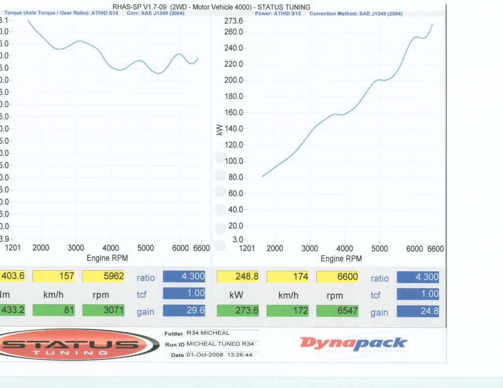

I have had the V Pro tuned about half a dozen times now... 3 times before the build and 3 times after the build. Only in the last 2 tunes have we really perfected the A/T Shift Compensation in terms of ignition retarding. The car shifts perfectly and loves the power - able to fry the tyres from standing start all the way to the top of 3rd gear. For those who have read my threads, the flex plate needed a beefing up as it broke at 330rwkw :blink:
i was wondering when we were going to see your car satanic ! Thats some great numbers. Do you have a dyno sheet so i can see the curve ? You have the extra 500cc and the 26 head to aid low end responce no doubt over the 25.
The flex plate problem seems to be R34 only doesnt it ?
