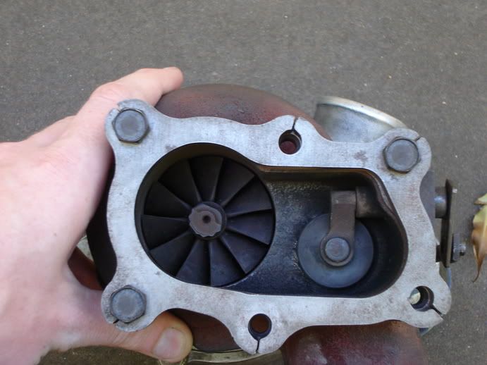

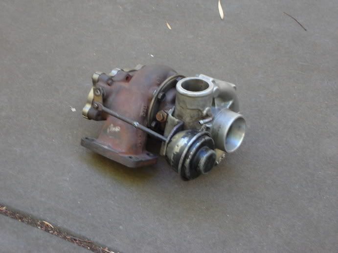

http://i3.photobucket.com/albums/y65/Ceffy_SA/DSC00096.jpg
http://i3.photobucket.com/albums/y65/Ceffy_SA/DSC00097.jpg
I currently have a Rx7 turbo installed on My RB20DET Silver top Cefiro, its basically a Rx7 HT-18S turbo of a S4 Rx7 but it has had a RB20 turbo rear exaust housing fitted to the turbo and the large steel wheel from the Rx7 turbo has been kept with the Rb20 turbo exh housing "machined" to fit.
Overall the compressor is not much bigger than the STD RB20 turbo (from memory it was only 4mm bigger on the exducer side) but ther is not much lag at all, really, currently full boost (around 14psi) is available at around 2800rpm, "Spool up" time is increased a little but its not huge by any means. I havent had it dynoed properly yet or tuned yet for the new turbo but the car does seem alot quicker with the new turbo on, boost no longer tapers off in the top RPM range and i can run over 15psi without worrying about the stock ceramic turbine shooting off. The turbo only cost me $500 and only required a custom oil line to be made up for it (going from ball bearing to plain bearing)
Yes Ceffy thats exactly what mine looked like from the back only with the slightly larger RB25 type turbine housing .
