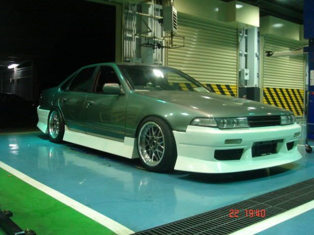

Stich Evolution 18x10 +8 Offset F 18x11 -1 offset R
8mm spacers on the front, helps clear calipers
Falken Azenis ST115 235 F 245 R
Bolt on flares smoothed over, front wheels inside the guards around 5-10mm... rears sit out around 10-15mm
Not alot of camber, prolly >2deg front and >1deg rear.... Lots of toe in on the rear though.

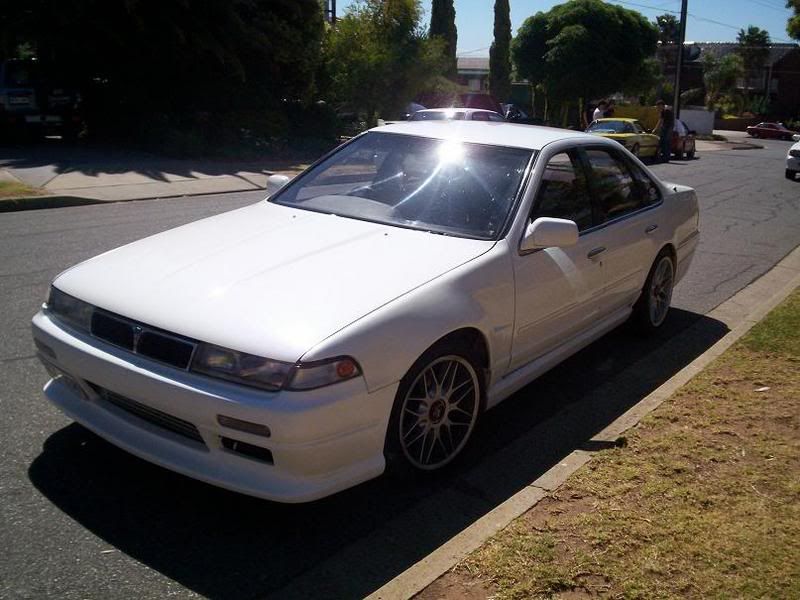

8J on the front with 235's and 25mm spacer
7.5J on the rear with 255's and 20mm spacer
still gotta roll fenders prolly gonna run 10J front and 9J rear in the future. with front over fender. not sure what im gonna use for the rear gaurds yet.
ahh sorry... i run it wider in the front for Touge (mountain roads)....
on the track i run it the other way... high speed drifts, or long eairly entry drags arent as common in the mountains..
i actually ruduce the stability of the car, in a sense, beacause it helps to swim through those tight mountain roads a little better.
