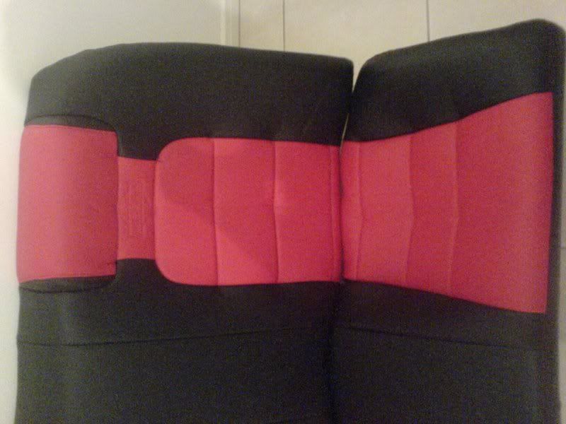

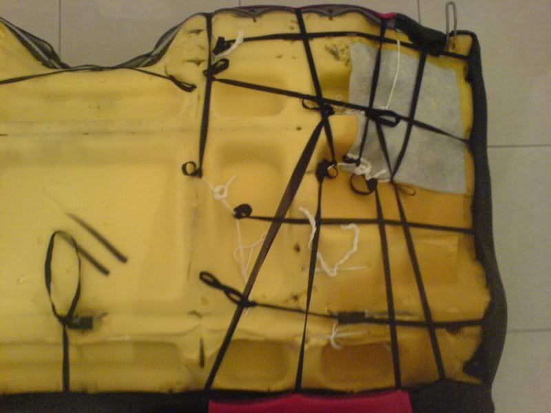

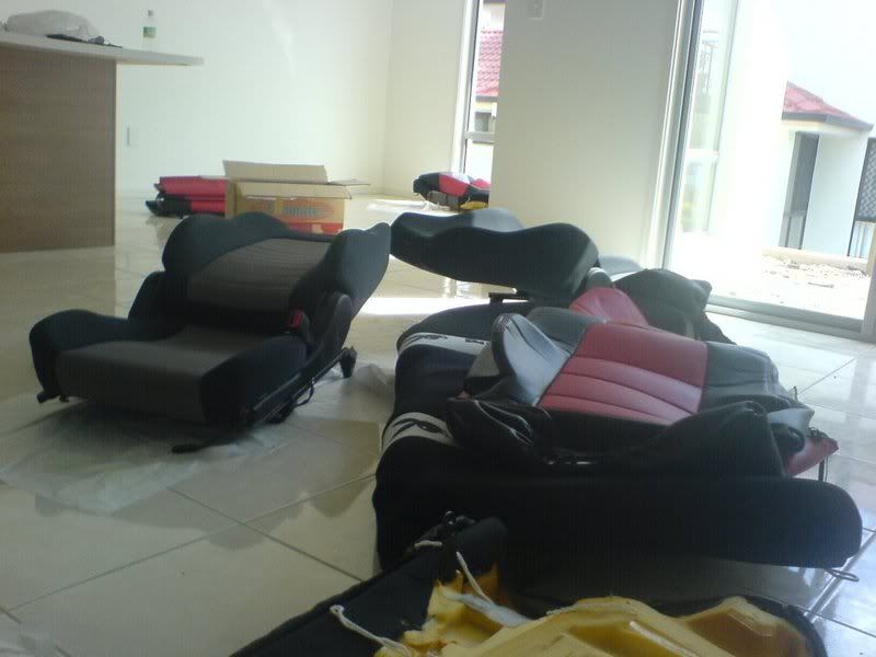

Yup, did it all myself (mate Ozan did his 34 at the same time - pics are from his house). Took a few hours on 2 sundays to do it.
Weapons of choice:
- thick, sharpened wire (cut a piece out of a coathanger)
- crochet hook
- long nose pliers

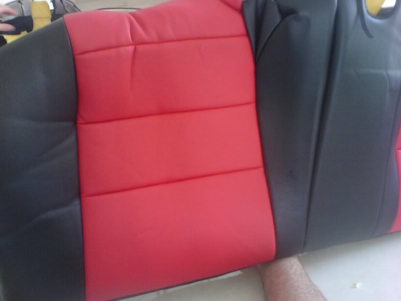

that look like a PRO JOB dont even look like a cover no more almost :).. is there any more picz of when u were doin it what things u did or more detailed instructions to installing them to look that good ?
looks fab
that look like a PRO JOB dont even look like a cover no more almost ;).. is there any more picz of when u were doin it what things u did or more detailed instructions to installing them to look that good ?
looks fab
I'll dig around, I think I posted all the pics up from working on em and a bit of a guide last time.
This time I'll just spray a bit of contact adhesive on the upper seat piece to finish the job - shouldn't look like covers at all then

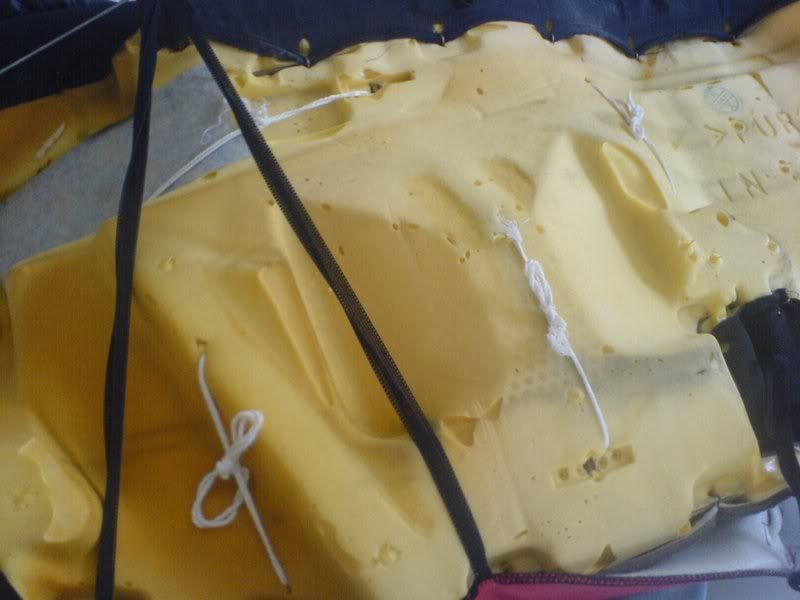

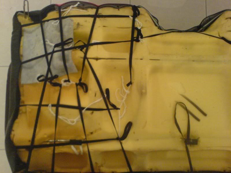

Easiest way to do the fronts is pull the base of the seat out of the metal frame - be careful, lots of sharp edges, I didn't get cut but Ozan did a few times :)
I didn't use adhesive last time but plan on just getting some spray contact stuff to pull it against the seat a bit more. You'll need a stanley knife to cut small holes where the headrests emerge and the seat adjustment controls are on the driver's side.
Make sure you pull everything tight! The strings/elastics need to be very tight (but be careful not to stress any individual cord as the string may snap and the material could possibly pull away from the stitching on the elastic).
When sewing through the seat you'll find it's probably easiest to sit on the ground with the seat on your lap. You'll find the stitching lines up fairly closely to the lines of the original seat, and when you pull the strings through you can test if it's aligned properly.
