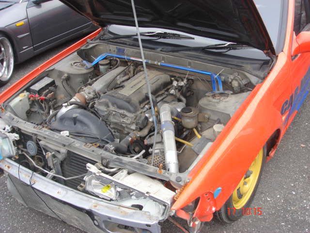

Dont get me wrong i may have gotten the translation wrong, but i have heard that by placing the FMIC behind the radiator will increase response. this is if you have the room to do so (with the SR i do).
no i understand that it will shorten the intercooler piping length, bhut wont the excess heat just negate the added response? now i have enough cooling knowledge/techniques to keep an SR from ever over heating. but thats with the intercooler in the front...

Take advantage of where you are living, rock on down to a couple of local workshops and get a quote on a V-mount setup :santa: The idea sort of defeats the purpose of using an intercooler. Maybe look at rigging up a trick waterspray system?
yeah that was my next idea... not hard to do myself since i am a bracket-making-master haha.. and yeah ill be running water-misters since that is also easy to do.. and i have tons of room for a extra tank...
but still not really i mean its still being cooled through the intercooler just not as much and im sure with the right fans you would see the response benefits..

I think you've got it confused
The technique your actually thinking of is to put the intercooler where the radiator sits, and the radiator sits behind that with a thermo attached, like here Intercooler/Radiator kit.

ok i double checked and my jap friend said that its true. run the intercooler behind the radiator is the way to go.. most people dont have the room so its not a possibility but with a set of electric fans (pulling air through) it should cool just fine and increase response.
in addition i think some water-misters would do the trick nicely with cooling assist.
i agree a V-mount is the best option... who knows i guess ill make a descision once it comes down to it...

So, you are going to sit a device, designed to remove heat, inside a hot-box (ie engine bay), and pass pre-heated air (ie air that has just passed thru the radiator) through it in order to cool the air charge being delivered to the engine.
How on earth can that be good for the engine?
I have seen one such installation - the IC was hotter than the radiator after a few laps of Winton racetrack.
Yeah, not a good idea. The air from the radiator will be heated as it passes through and then this is the air that will have to cooler your compressed air. Your water will be hotter than your compressed air so it is a good idea to have to cooler one in front, as heat transfer via convection is propotional to the difference in temperature
i agree playing devils avocate in this conversation i still cant see any reason why this would work anybetter than a regular setup besides an slight increase in response....
well ill shoot for a V mount... maybe a Z mount even since id like to utilize the extra room...

I think running the intercooler where the radiator sits and the radiator behind that will work better, and the pipes will only be soooo slightly longer. Don't see why you'd want to mess around putting it behind the radiator
Increase response... BY how much?... Noticable...? Unlikely... Costly...? Um yeah...
Waste of time man IMO... (been said before, but will say it again)... the hot air runs through the rad from outside... mmm not the best idea for intercoolers, last time I checked... and what about the heat from the engine bay, and your intercooler sitting in there and cooking??
V-Mount is a different story, but the bonnet is usually opened up, like on Pink Bits (Denzo's drift car). Just remember, the air needs to go somewhere...
exactly... shorter piping corect...
but switching sides for a second... the heat will heat the air and decrease the efficency of the intercooler..
but... switching sides once more haha... with the room i will still have even with the intercooler add a vented hood, and dual electric fans and the increase in air temp could be compesated and the benifits of shorter piping could be reaped.
remember also that on an SR the intake is on the opposite side of the exhaust and does not need the piping to be sent back to the exhaust side like the RB. so the shortness of the piping can be great.

if you put the fmic directly onto the radiator... hot air from engine bay will be pushed through your radiator, making it even hotter, and then onto your fmic, which is sitting against a boiling hot metal radiator, which will quikly heat up your fmic, very stupid, there is a reason alot of top mounts get water cooled, but yeh if you do want response and efficiency, may be at a bit of an extra cost, go for a water cooler fmic unit, if not then the v setup
But lets look at it this way. Doesnt the exact same thing happen with the intercooler and A/C thing? So then you have more hot air going through your radiator? Thus making your engine hotter?
I can see where the theory comes from. It does make sense on paper, just in real life it wont work as good.
That's exactly right. That's why a lot people have overheating problems after they get an FMIC and/or use their A/C
The exit stream from your intercooler is a lot cooler than the exit stream for the radiator as the compressed air is cooler than the coolant. Blah blah blah

ok lets switch this thread up a bit... we in theory know that this wont work well due to the amount of heat and air blockage...
Now lets throw in the AC cooler... how would you fit that into the equation if removing it is not an option?? i was thinking of pairing the AC cooler and the radiator together on the bottom of the V-mount... with the cooler in front of the rad.
