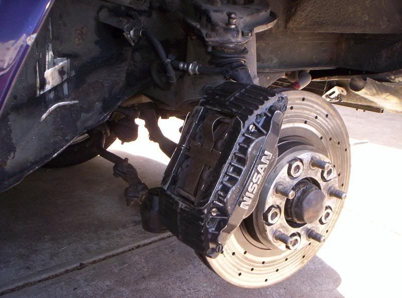

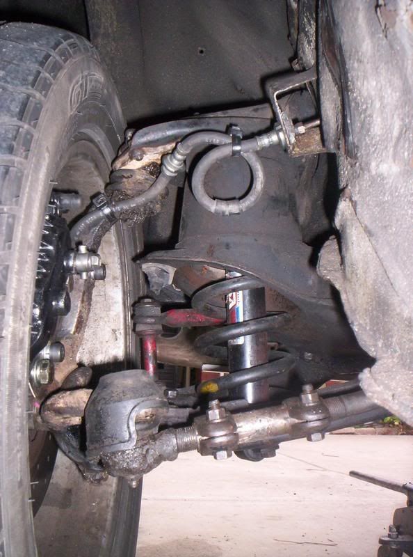

for all you new members out there that havent met me, my names pete and i own a 1966 Prince Skyline GT-B ( thats right a 40 year old skyline GT)
the crazy brake up grade and suspension rebuild has finally come to fruition......
so now on the front to replace the snapped king pins i have use 4 cylinder prince ones( the only ones i could get my hads on in australia) with complete custom backing plates and adaptors, R32GTR 300mm cross drilled front rotors with R32 Type M 4 piston calipers and U12 pintara brake lines.....
here's a few photos.....
so with the few other mods to be bolted in ( afc, ebc, new zorst and R34 Neo Turbo), im hopping to see ya all on the road soon...
Pete...
