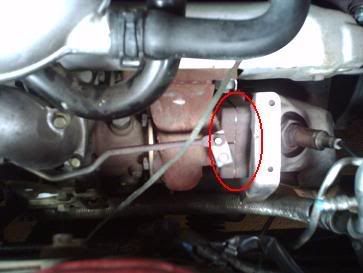

do u mean this part that could be lose? cause i have tried every bolt around there and i cant move any i have also checked every intercooler connection for holes and even spayed carbi cleaner on it at idle to see if it done anything
