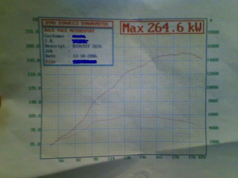

Got the dyno results, pretty pleased but i think there is a little more in it.
The differance is GREAT though.
Here are the B4 and after graphs.
B4 (red) = Previous exhaust and K&N pod
After (blue) = New exhaust and BMC pod
Power: (Average of about 20-30rwkw gain throughout the mid range)
Torque: (Over 1000N of tractive torque gained at 122km/h >_< )
Need a new boost controller as the factory solinoid is unable to keep the boost steady with the wolf controlling it :) . So once this is done, i will get a final tune. Boost drops to about 16psi at peak, but is a little wavey all the way through.

Picked it up today and boy did i enjoy it :dry:
The delivery is very smooth, but sharp/fast. Definately noticed the differance in 2nd, 3rd, and 4th, the rev limiter just comes on so quickly :D , can't wait for DECA and the coming cruises.
SS8 Gohan: I truely beleive at least 90% of the gain is from the exhaust, but i have seen other cars just change pods to BMC and gained about 3-5rwkw across the curve. BMC filters are top quality and aren't cheap, apparently they are used in the F1 cars, they have great flow and filter very well.
Jetdat: Very interesting!
As you know i am using the smaller brother (gtrs) so that would probably explain the steep curve. But i also have tomei poncams and head porting, which is probably why i am making the same power and more usable power; as the power is bought on earlier and is held longer. Not sure how much boost you are running but mine peaks at 18.5psi, then tappers down to 16psi buy the time it makes peak power.
