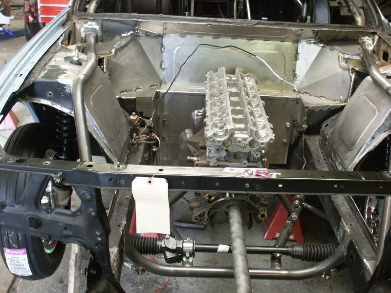

Well after 7 months off the road/track the car is starting to take shape. :)
Really hoping to be finished by the end of June.
A lot of changes made to last year that I hope will help the car drop the times a fair bit from last year biggrin.gif
The RB25 we used last year has now been swapped for an RB26 (we will keep the RB25 though & drop it back in when the season is finished in October to drop last years times further on the RB25 - 9.93)
Hope you like what we are doing

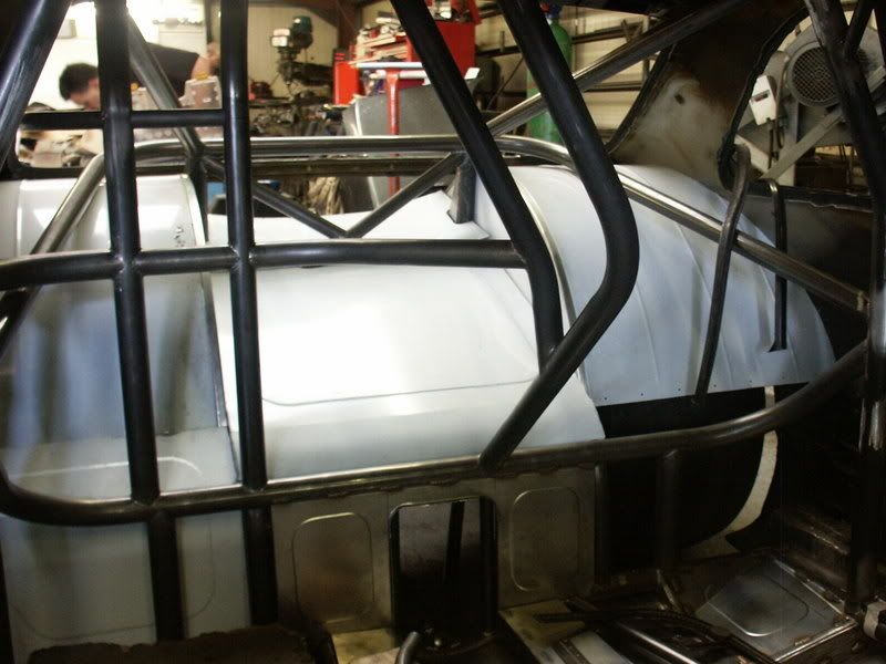

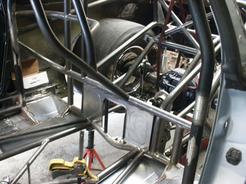

Still the existing GTST shell (with a lot taken out), std front wings & carbon doors, bonnet & boot lid.
Car has been back halved - I would have loved to have gone with a full space frame but not just yet.
Holy shit. That's some serious gear in there. So apart from the engine bay frame rails, outer skin on roof, quarters and front apron it's all tube?

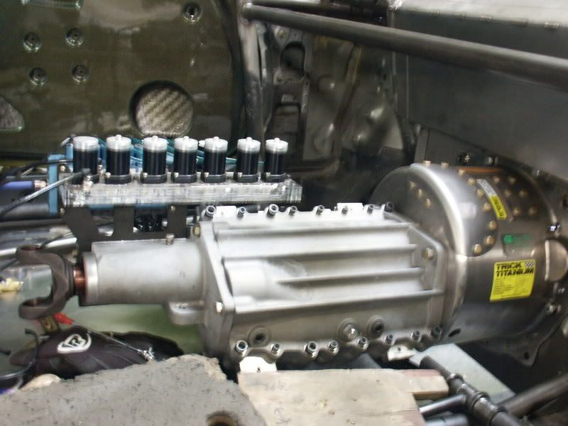

5 speed jerico with air shifter - should make a huge difference to last year.
be great to be able to change at full throttle :P
Everything's good here John - my minor upgrades to the gtst pale in comparison. Which box have you put in it?
https://www.sau.com.au/forums/topic/171067-r33-drag-gtst/#findComment-3159120
