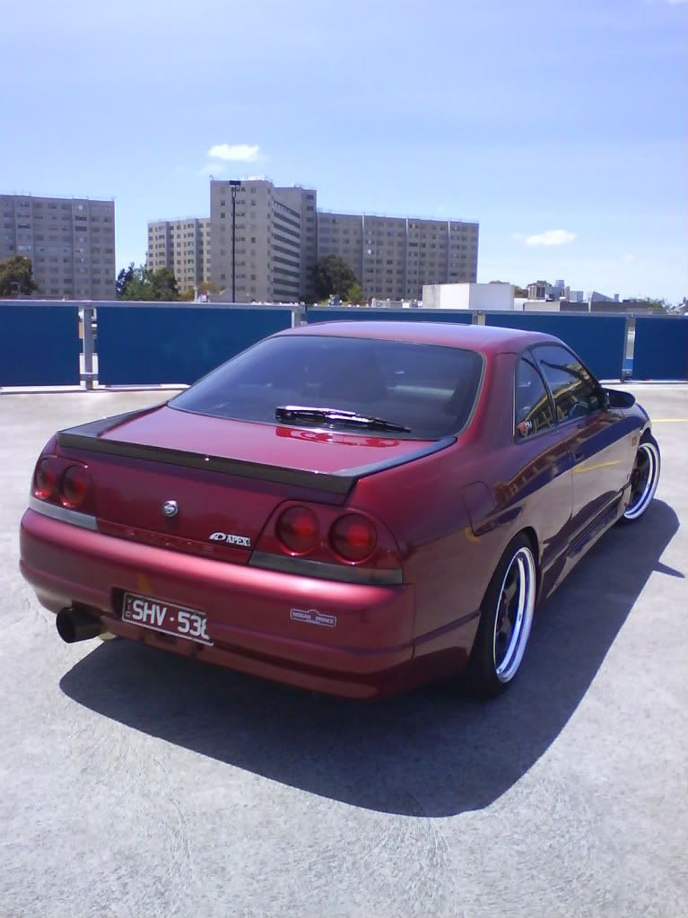

i run 18.9.5 +30 (18x8.5+30 front) on an r33 gtst with no flare and near flat camber (just a roll) and its an easy fit... the 34 guards are bigger again, so 9.5 +20 will get you about the same fitment as me, and i still could go out a bit more... say another 10mm before i need to flare
Most people are way too conservative with offset. 33's can definitely fit +20 9.5" rims at the rear and +20 8.5-9 at the front with guard work and it will look a huge deal better than +35 and above offsets. Just don't run bulgy oversized tyres. 265-275 for 10", 255-265 for 9.5", 235-245 for 9", 235-225 for 8.5", 225-215 for 8". Any lower width and the rims are no good for a turbo skyline.
