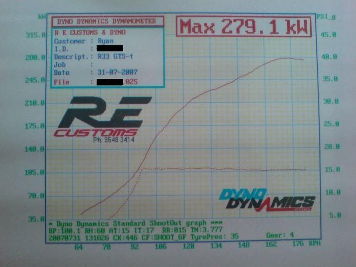

Well I just picked my car up from RE the other day after a tune and I am extremely impressed with the results and thought I'd share them with my fellow SAUers, aswell as get any thoughts or comments. A big thanks goes out to Ray, I'm sure his more than sick of hearing my voice now. I can't reccomend him highly enough, I'm over the moon with the result, everybody who rides in my car can't believe how responsive it is for a 280 rwkw car. Now to build a new motor so I can ram more boost down it's throat without worrying about melting it.

Cant complain with those results man, nice work.
You must be over the moon as I could imagine, must be sweet to drive especially with that power curve!
Is it just a stock RB25 internally?

Yeah mate I'm rediculously happy with the outcome, I was thinking more like mid 260 rwkw region, which is around what it makes on low boost! It's an absolute DREAM on the street (well as much of a dream as that power can be). As for the engine, yeah its bog stock internally but I'm looking to get one built in the near future not so much for power, but more for piece of mind as i dont want to go melting an engine.

Thats awesome man, for bog stock motor. 279rwkw is massive.
Must have some serious traction issues now lol
Looking at getting CAM's or anything for it at all?
How much boost did it take to get to 279rwkw?

Yeah its a handfull on the road, at full noise 1st and a fair bit of 2nd gear are useless when hard shifting. It's made the car soo easy to slide now, on the straight, just clutch and then throw it a little and then balance the car with the throttle, my mate in his 2535 powered 33 cant keep up with me when we do slalems now, REVENGE!!!
As for the CAMS, I'm looking into purchasing a built motor off a guy on here, it comes with stage 1 HKS cams. Otherwise I'm going the build my own.
That power was made on only 16 psi, but it drops 1 psi over the graph as the boost controller wasnt fully worked out, but I've since sorted that, so theoretically it should have actually made a smidgen more power.

nice curve, good ramp, nice average power
you boost build is ideal at 3300rpm where it ramps to 15psi aggressively (how is traction?)

Hey Paul, thanks for that comparison, its nice to actually have a solid evidence of my progress. As for traction, through 1st its non existant, 2nd it hooks up at about 5 grand and just takes off from there. Admittedly, my suspension is set up for drift with stiff zeal coilovers all round (cant remember the rates off the top of my head). The best thing about all of this is the satisfaction I get from driveing something I built.
Milan: The car didnt even hit knock levels at 16psi which is all it ever sees now that I've sorted the boost control and it carries nice afrs throughout the rev range. On here its a pretty normal occurance to see rb25s running 300rwkw throughthe likes of gt30/40's and 35/40's on stock internals. But I still dont like running it internally stock, hence why I'll be getting an engine built within the coming months and then aiming for spot on 300rwkw (around 20 psi should see me there). Im just thinking to stick with the 25, or go 25/30 and a bigger exhaust housing, any suggestions?
