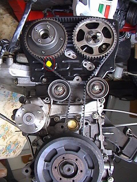

Here are the instructions on how to disable the VCT on your RB30DET with no external oil feed required. Just two little grub screws and a welsh plug :)
I wish i had a better photograph (with the rear timing cover off) but i don't, so this will have to do:
where i have marked (approximately) on the head there is what appears to be a copper welsh plug. It looks, from the outside, like a normal welsh plug, but it is not. it blocks the front cam bearing from recieving any oil via the lifter oil feed rail (big long casting hole which runs next to the lifters, you'll see it with the cam cover off). it supplies high pressure oil to the lifters and cam lobes, and is fed via the block oil restrictors.
what you need to do is drill that welsh plug out. you'll see what i mean about it not being normal once you're through the first layer of it. don't do this with the engine assembled, swarf goes everywhere!
when you have removed that weird looking plug, the front cam bearing is now recieving high pressure oil all the time, same as the other lifters.
now, there are two holes in the cam bearing face, one is connected to the lifter's oil feed (high pressure) and one is not. you block the one that is not with a grub screw (tap it in, screw it in, stake it) and drill a hole in another grub screw as an oil restrictor (same size as the other cam bearings' holes). this other grub screw (restrictor) then goes into the hole that is now connected to the lifter's oil feed. plug the welsh plug hole up with..... a welsh plug (18mm i think from memory?) and you're done.
so what you have in effect now is, a full oil supply to that front cam bearing all the time. problem is, this will activate your VCT all the time! not good! 20 degrees of cam advance isn't as good as it sounds. the cam has a trench milled in it with a couple of holes which allows the oil to pass through to the VCT mechanism.
so you need to take the big eye bolt out of the funky cam end and weld the bolt closed. this normally allows passage of the high pressure oil to the VCT mechanism in the end of the cam gear. with this welded closed, no oil can get through to the mechanism.
if you have a head apart, you can easily see what i mean. it's hard to understand without pics but anyone who's taken one of these apart will know what i'm talking about.
2500km on mine and going strong - it must be working!
cheers
