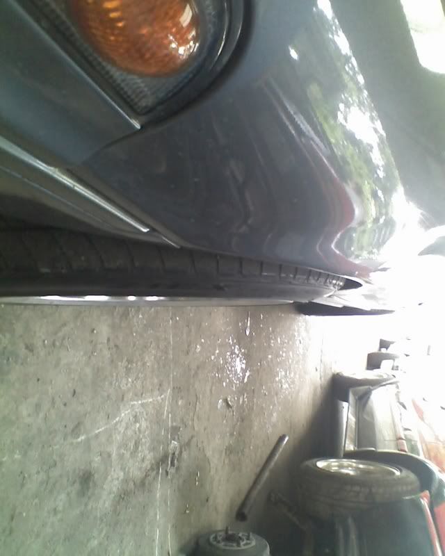

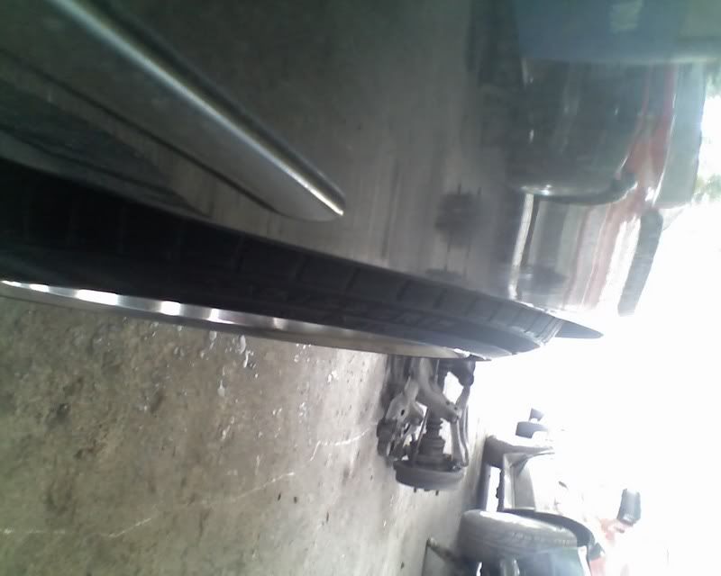

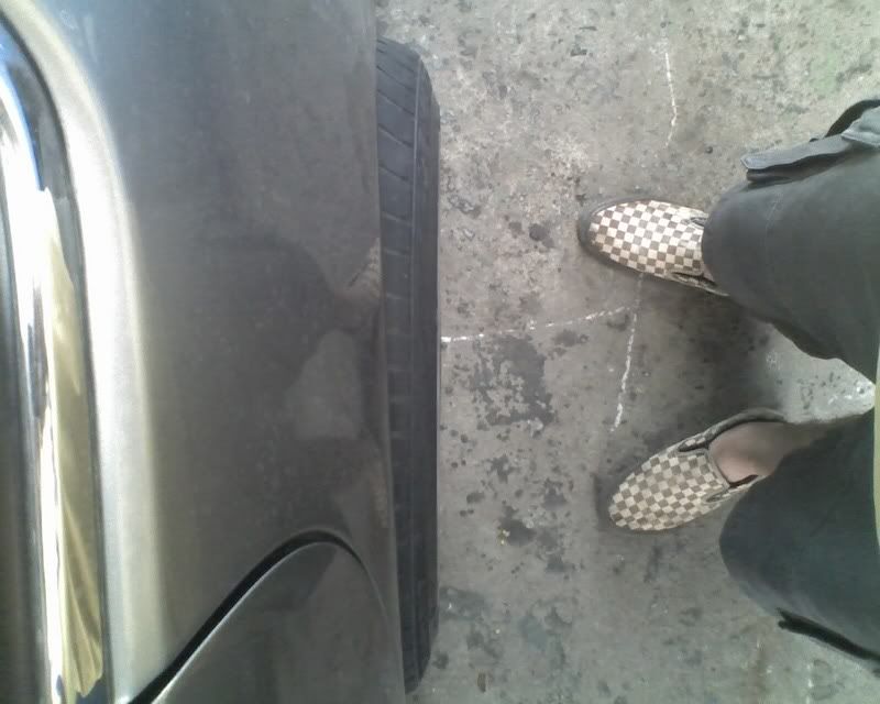

here is my rear wheel sticking out. Im still thinking whether to use flares or just roll the fenders.
the rear has a +10 offset. during the time I took the pic, the rear was in a negative toe since the hicas bar has not been installed yet so the wheels doesn't look straight.

those rears look pretty sweet, how wide r they?
i say decently roll em. flares are for wider rims, there nuffin worse then a car with nice wide flares/guards but u cant fill em in well, at least thats my thoughts :P

Mate don't go bolt on flares, those wheels will fit perfectly after flaring the back guards. What width are those rims? 9" or 10"? Couldn't make out in the photo if those tyres are 225/45/17's or 235/45/17's. You could also stretch those tyres a little bit more for more clearence, 225's if they're 235's or 215's if 225's.
Thats mad. What about front ? what offset ? What rim width? Tire sizes ?
Here are the wheel specs and tire size:
front- 17x8 +5 offset tires-215x45
rear- 17x9 +10 offset tires 235x40
I just mounted the front earlier and it just sticks out about an inch only so now, I opted to have my fenders rolled combined with a camber plate. :)
Dan_J,
I'll just roll them since the flares is actually my last resort if rolling won't be enough. :)
Hypnotik,
Yeah, I find the flares a bit out of shape for the car as I test fitted some. I prefer the stock looking body with rolled fenders. :)
