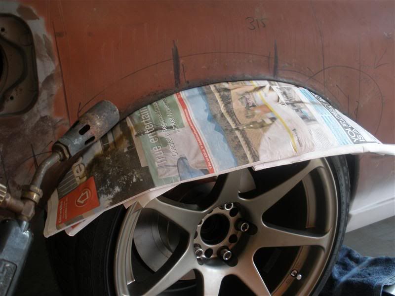

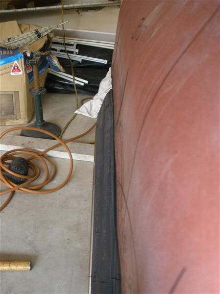

Myself & a mate flared the guards on my S14 a month or so back.. Im running 18x9 +25ish on the rear of the car with the 265's which came with them & I have my car on the deck.
Her'es something different if your ballsy enough to try it :) worked awesome for me...
We used a jack handle first with a heatgun to roll the inner lip slowly driving back & forth.
Then once the inner lip was rolled we got 2 sheets of thin Ply, 2 very thin pieces of aluminium & a scissor jack for the flaring.
Put the scissor jack in your wheel arch & wind out so that it has alluminium then wood pushing against your guard slowly heat the arch & keep increasing the tension on the jack & it will push your guard out.. you will have to move the jack 3 or 4 times so you get an even flare but the results were excellent.. I got about an inch out of my guards with no cracking, so now I can fit my 18x10 +18's :D
Pics below... If any of you have seen standard S14 guards you will appreciate how much flare we have got in the 2nd pic..
