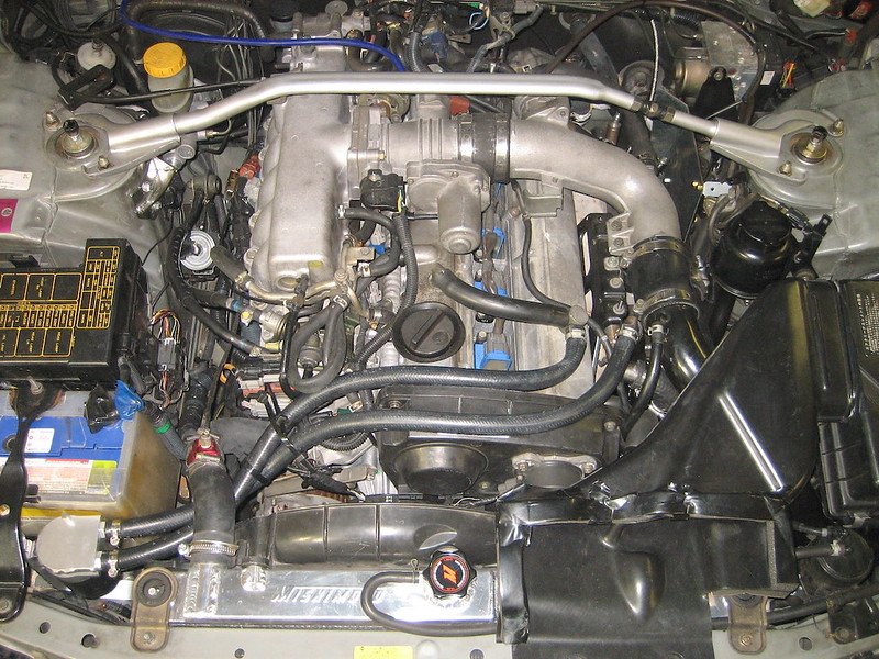

Question: Is it possible to install a large 1 to 2L catch can without shifting everything around in the engine bay? I've seen some GT-R bays with a custom box where the battery is but that's obviously a battery relocation job.
One possibility could be the front left guard, at the OEM side mount IC location, but I have no idea how you would run the hoses there?
