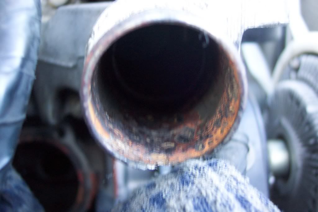

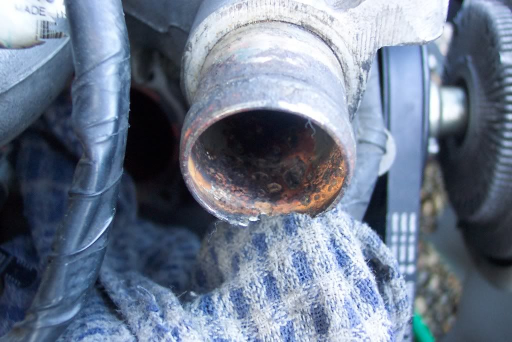

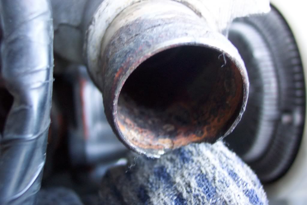

Took out radiator and the top and bottom radiator hoses today, coolant was suprisingly nice and clean, but the top raditor pipe was full of rusted metal crap, the big nipple on the intakemanifold were the top raditor hose connects to has rusted away at the front of the nipple (see pic) which has obviously been rusting for a while sending rusted grunk crap threw the motor/radiator etc etc, which has probly blocked the radiator causing the car to overheat, the bottom of the overflow tank was full of brown rusty water which i didnt spot before hand.
Possibly one of the previous owners didnt use antifreeze, or not enough antifreeze which has caused the steel nipple on the intake mani to rust pretty quickly, hence causing my problems.
I will try and give the nipple a bit of a clean up and get most of the rust off, then flush the whole system heaps times, instead of get the stock radiator flushed/cleaned i might get an alloy one instead (will help with cooling when i start doing some track racing) ,and some new coolant ofcourse, i will update this thread when i have everyhing back together and hopefully fixed.
Pics of rusty nipple!
