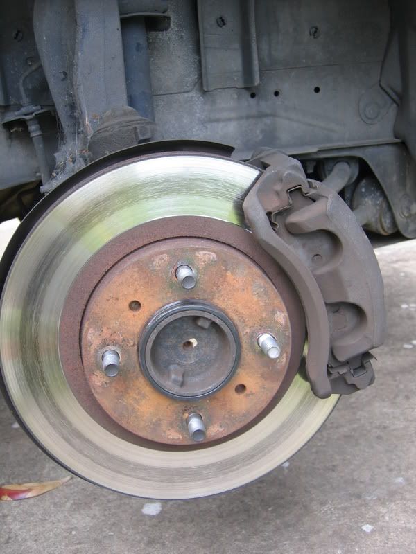

Here is a pic of the driver side rotor....what do you guys think??

And another view
http://i21.photobucket.com/albums/b258/EMZR33/IMG_3463.jpg
(worth machining or.....????)

lol, funny mate... they look as smooth as a baby's bumb... no way to really be able to see from a pic..
you could take them to almost any automotive mechanic/tuner and they will know the places to take them to be machined....
