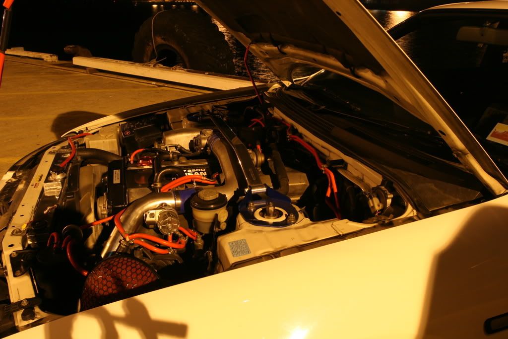

Here a pic of my "smick" engine bay with alloy radiator =)
