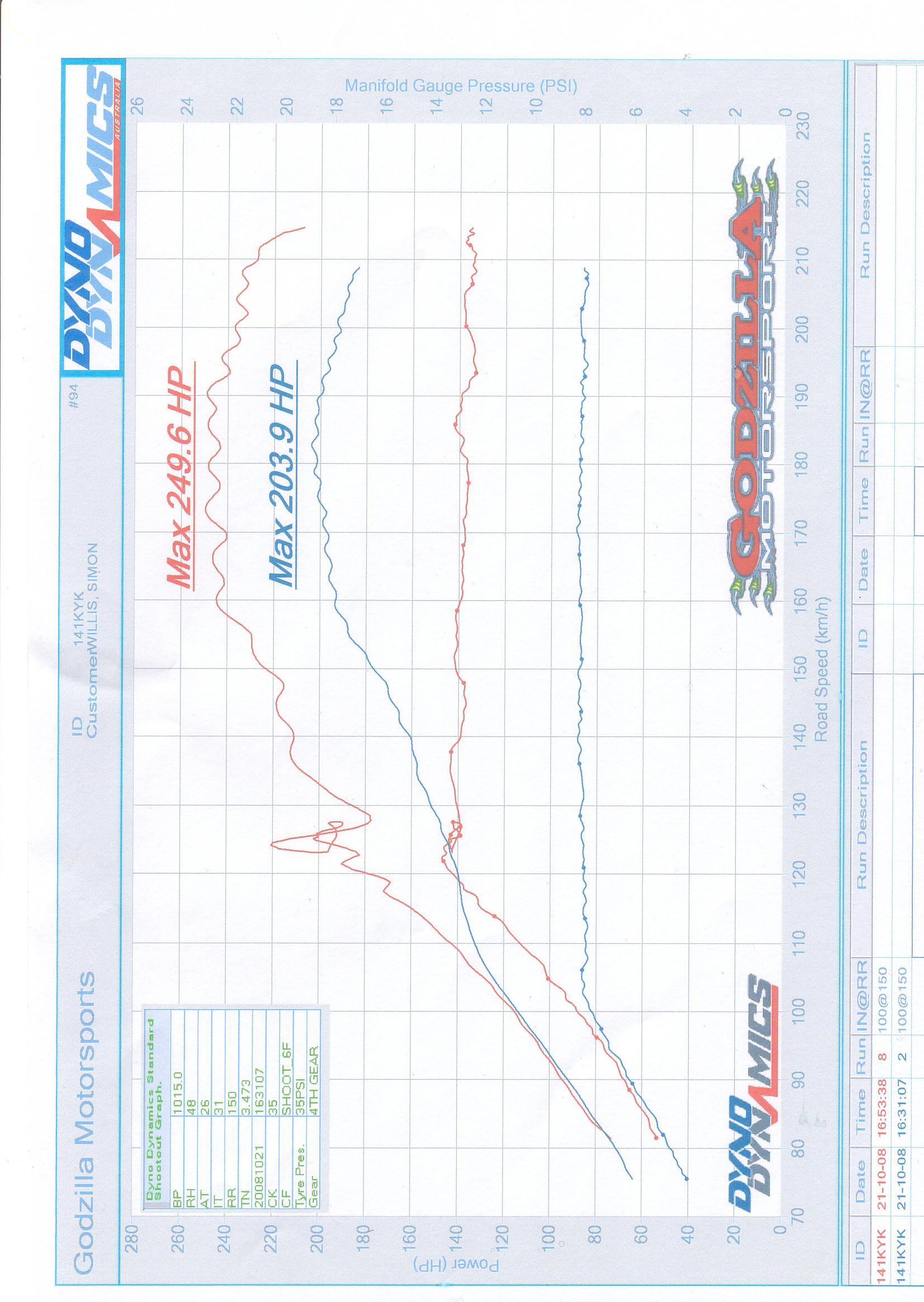

Well I made up my mind quickly and got a GTR plug-in board fitted to my Stagea 260RS last week by Mark at Godzilla Motorsport. For some reason with the stock ECU my Stagea had a rough idle that was very lean. As soon as Mark fitted the Vipec the idle came good :P He then fitted a boost control valve (using the wiring to the stock boost solenoid) and tuned it to run 13psi. All up the tuning only took 2-3 hours and went quite smoothly. In the end it was producing 250HP @ 13psi with a conservative tune (~11.8:1 AFRs up in the revs). This is my daily, so I want it to be reliable. The only other mods to the car are dump-back 3" exhaust with 2.5" compliance cat (even running stock airbox). There were a few small differences with the A/C wiring in the 260RS compared to the GTR, but these were easy to fix. Oh yeah, I'm running a MAFless tune and was able to wire a switch to one of the Vipec's digital inputs to trigger high or low boost. Low boost is 8psi, high is 13. You can see from the dyno sheet that the Vipec holds the boost welll at 13psi and has minimal overshoot.
The car idles nicely, starts first time in the morning and has no problem idling with the A/C on. It sounds much nicer than before and revs smoothly. It certianly pulls much harder than before. I noticed a huge difference up in the revs.
Thanks heaps to Mark and the guys at Godzilla.
For some reason my crappy work computer doesn't have javascript and I can't attach the dynosheet. You can get it here
http://www.justmurph.com/willy/Stagea/Dyno...021-10-2008.jpg
Dyno video: http://www.justmurph.com/willy/Stagea/P1030318.MOV

Thanks. Looks like you're happy with your results. Happy cruising! :P
