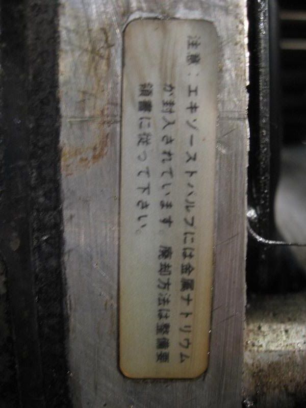

Found A Sticker On My Rb26 Head Need Translation If Possible
