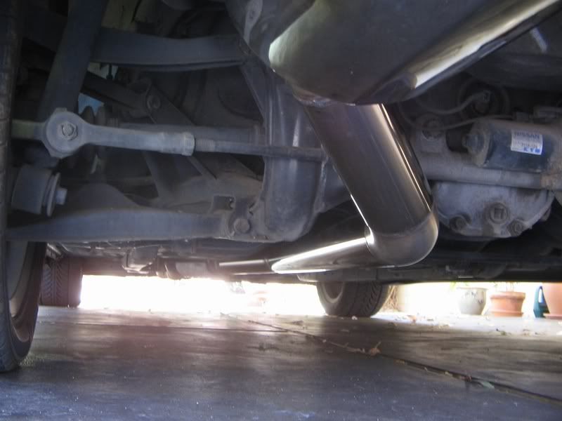

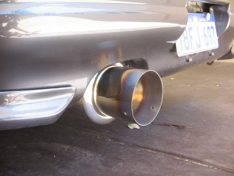

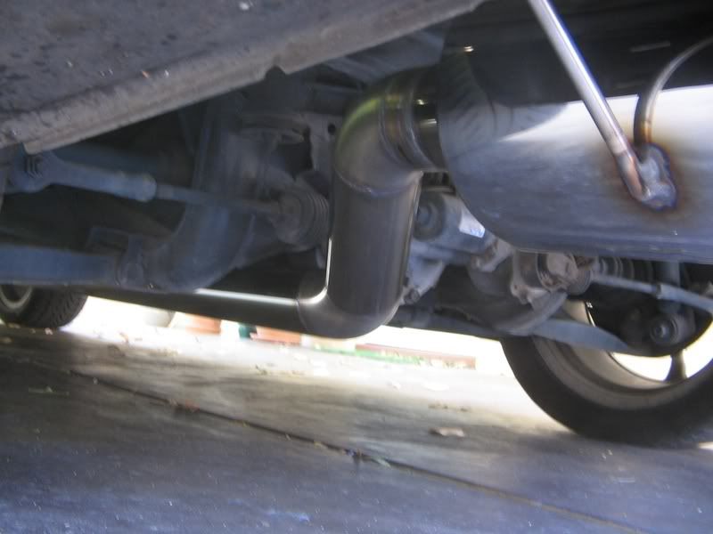

Cat back, get Kermit to do it. He does awesome work. I don't know if you looked at my R33's exhaust at all, but it was done by him. Top quality work. I'll scratch around for a pic and post it up.
