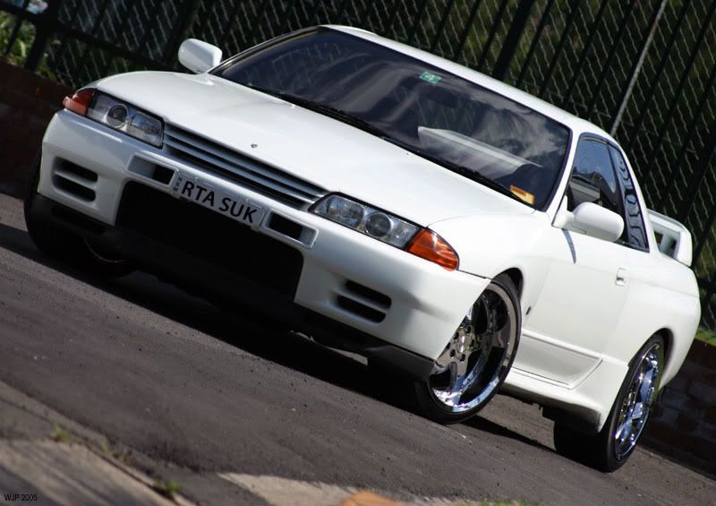

Here's some piccies, forgot to post these in here but some of you may have seen them on CC or in the R32 pics thread. I've changed the mangled number plates and I have my new grille sitting on the loungeroom floor waiting to be fitted.
White hey, good choice! Here's mine;
Whats wrong with your grille? Id add a few N1 parts and be done with it. Looks like a very clean car you've got there :O
