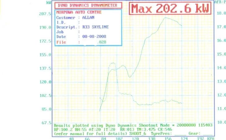

have a look at this run see how lean she is at low rpm :D and then hits r&r im not too fused but she was a good motor maybe i should whack another bottom end on it this. The other build up is not gonna give me much change from 30g ill tell yas all about it after. :P
pic of dyno graph

damn that dyno chart above, lol, nasty

Ive got the toshi ecu remap chip, great, heaps rich LOL but timing is pretty good. safc is in bigtime negatives atm, so plenty of scope for the extra 700cc injectors to be switched on thru a rpm/wot switch for safe fueling.
