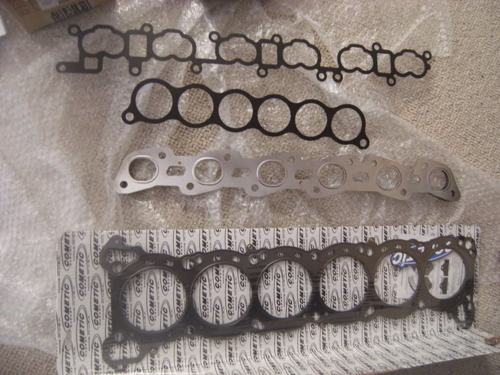

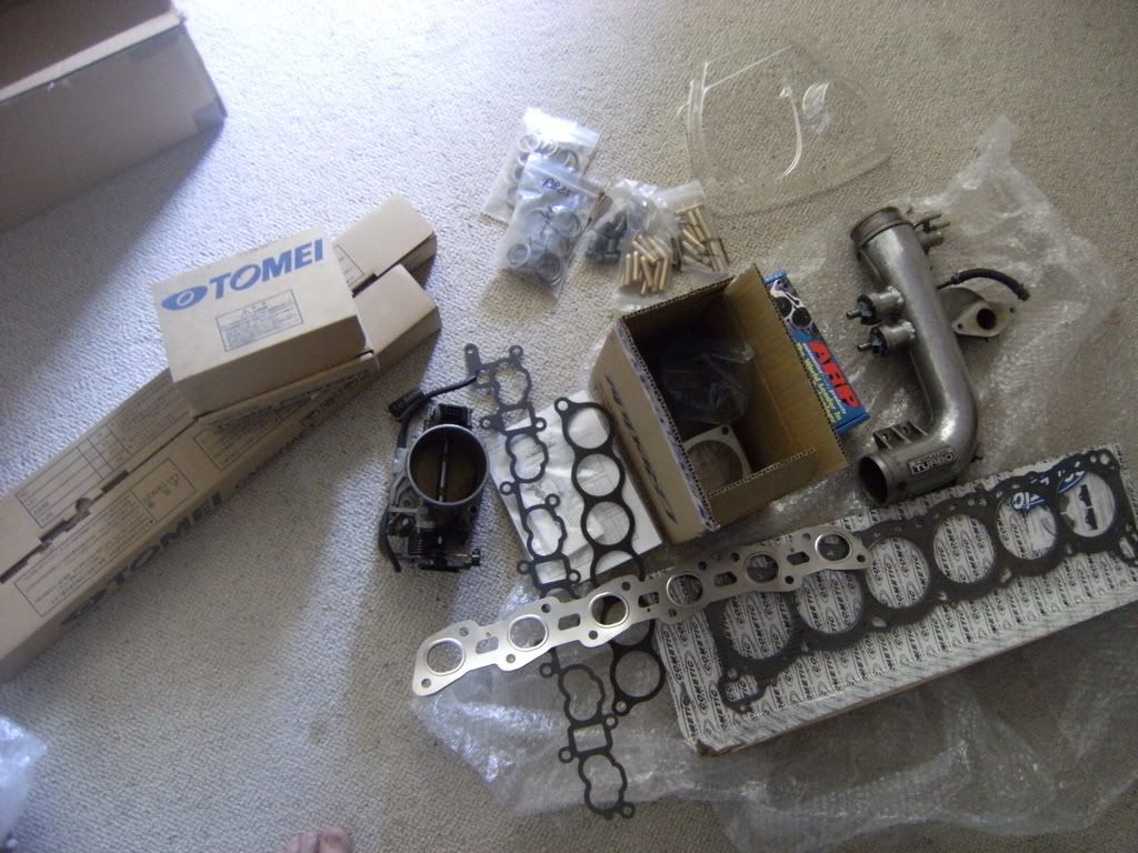

Cometic intake manifold gasket, intake collector gasket, exhaust gasket, and 1.2 x 87mm head gasket
arp head stud kit, intake / exhaust valve seals, intake / exhaust valve seats, intake / exhaust valve guides, oil restrictor,
2x700cc sard external intake manifold setup
clear cam timing cover, q45 throttle body & adapter kit

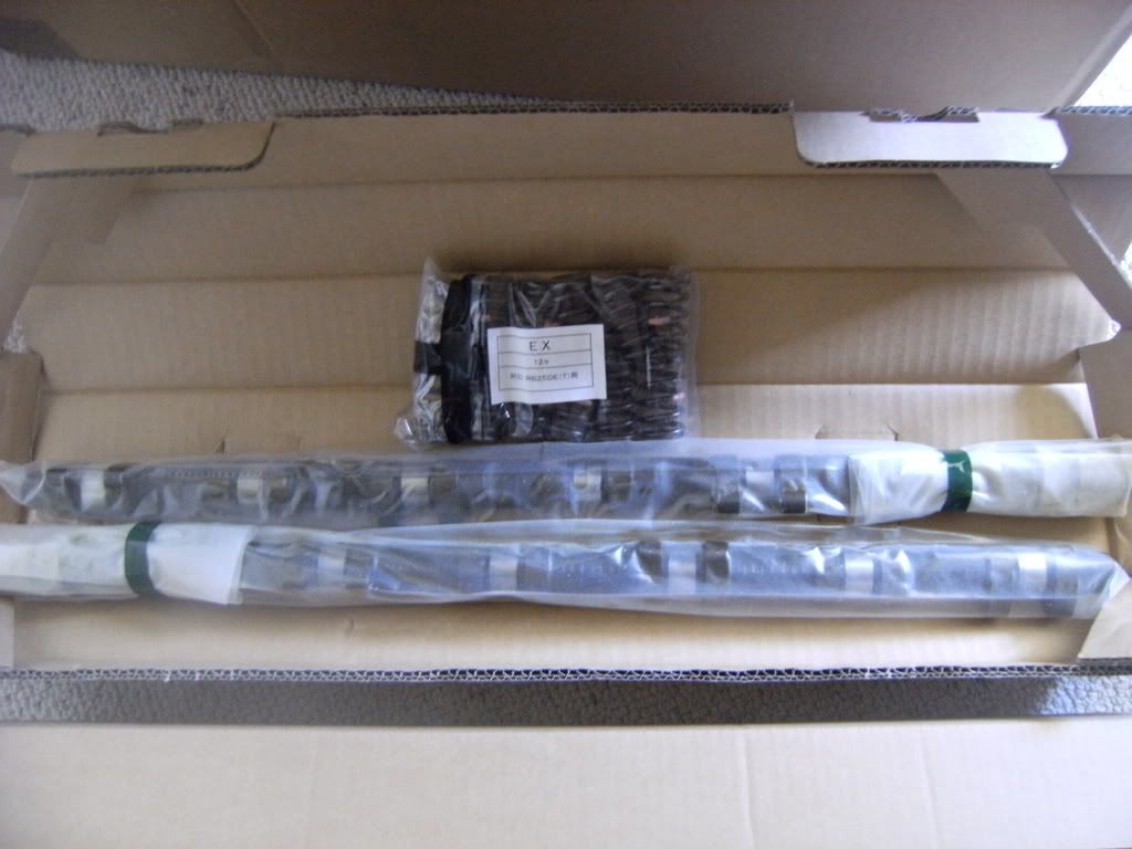

256 poncams and 8.8mm hi lift springs
