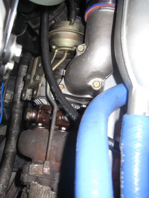

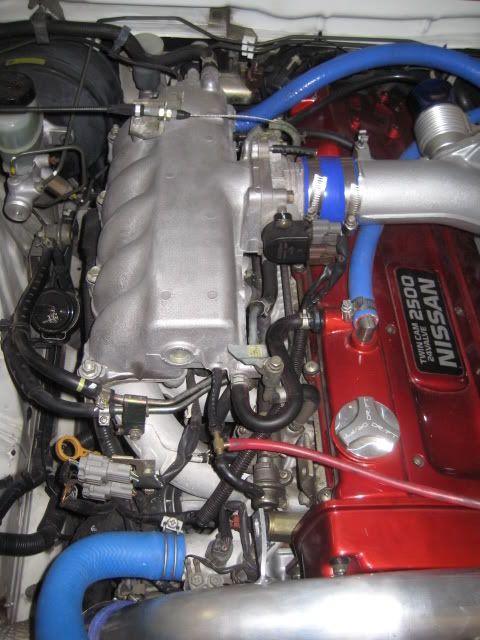

Err not that it's really going to help much.... but anything stand out obvious wrong from these couple of photos lol. The oil feed banjo isn't sealing 100%.. i need to fix that but I don't think that would be doing it..

Hey yeah i can the wastegate flips open and closed without the arm attached to it just as easily as the old one.

if the gate was stuck open it would go into vacuum instantly no problems and build some boost
it would just be mega laggy to build a useful amount of boost
but getting to 0 should be almost instant with gate leaking or not
it sounds like your manifold isnt pressurize, ie; your engine is atmo
this explains why you cant reach 0 vacuum
Yeah maybe you just forgot to tighten a hose clamp and its half blown off.
If its a bush bearing highflow it will be laggier again over a turbo thats BB of the same specs or a standard turbo. It won't deliver the boost as nice as a BB.
Yeah i'm gonna pull the dump pipe back off... make sure the wastegate flap is 110% closing correctly and make sure the arm is pulling it shut... when that's off also make sure the wheels are still spinning together and are tight... after that I think there's nothing more i can really do and will gladly pay a shop to fix whatever it is.
im having a brain fart but it seems like I have had this problem before. Maybe some how that turbo is out of spec?? The boost is suppose to be built up in the compressor housing and then distributed throught out the intercooler piping. Almost sounds like it may be sucking but not pushing if ya know what I mean. check the gasket on the comp housing. I think that fixed my problem before. It suxed trying to find one. or take the turbo off and get it checked by a pro. Or if ya have a freind with anouther turbo borrow it.
Good luck
Just had another look at pics.
1) Move your pressure source AWAY from your FPR.
You should NEVER tee things off the FPR signal line. You can cause pressure drops when putting things on that flow air etc.
2) Your hose clamps on the hot side of the intercooler to turbo seem to not be sitting right. Undo them, line them back up, redo them.
