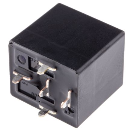

- The new relays (duh!) The ones I pulled from both relay units were branded Matsushita CB1-P-12V, I found replacement Panasonic units from RS Components Australia online, their part number is 815-5094. the price for two was about $14 inc shipping.

4. Usually only one of these relays fails, but it stands to reason if one has gone the other probably isn't far behind so good practice to do both. If you give the whole unit a shake you'll probably even hear something inside one of the relays rattling around, a sure-fire sign it's shot. If you inspect the new relays, you'll see they mount via 5 little prongs, so to remove the old ones you need to get the solder off those prongs that holds them to the circuit board. Note that on one side only the outer 4 prongs are soldered in, the middle one is not soldered.
Place the soldering iron tip on the solder around the prong, the aim here is to get the old solder melted again so that the braid can be used to soak up the solder. Have the braid handy and feed it in, or put it under the tip of the iron between the solder, either works really. Just be careful not to contact the plastic circuit board too much, you don't want to melt it. The braid and relays will get hot if it contacts the iron for too long so be mindful of that.
Do this for all 5 solder joints on one side, and all 4 on the other. Take your time, you need to remove as much as possible or it won't come apart and you risk breaking the circuit board when you try to remove the relays.
6. Once you're confident the solder is removed, you now need to separate the relays from the circuit board. They usually don't just pull off, so I found the best way to remove them was to use a bench vice.
Very gently wind the vice in so there's just a small amount of pressure on the sides of the board holding it in place. Can't stress this enough, do not tighten, you just want it suspended, you don't want to snap it! Then using a metal punch and a hammer, very lightly tap the tip of each prong of the relays, working your way around each one and you should see them slowly slide of the circuit board. When you have a tiny bit of movement you should be able to pull them off by hand.
7. Now push your new relays onto the circuit board in place of your old ones. Make sure they're on snug and now it's time to bust out the soldering iron to solder them back in place. Put the iron on the prongs and give it a few seconds to bring some heat in, then try and melt the solder onto the prong (not the iron). You don't just want a blob on the prong, it needs to melt onto the circuit board as well or you won't have a good connection between the two. If you keep the iron on it for a few seconds you should see it dip and sink into the board. Don't be heavy handed with the solder here, you don't need to feed a lot of it in just enough to cover the prong and make that contact with the circuit board.
Repeat for the 8 other prongs (9 total).
