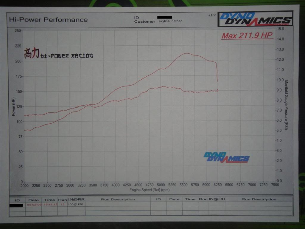

Model - R34 25GT Sedan
Engine - RB25DE NEO
Modifications / Parts Used - RB25DET Factory Exhaust Manifold, R33 Series 2 Turbo, JJR Front/Dump Pipe, Custom 3" Mandrel Bend Catback system with 5" canon tip, Magnaflow Hi-Flow Cat, R34 GTT Injectors, Walbro GSS342 Fuel Pump, Monsta Performance FMIC Kit, Turbo XS Recirculating BOV, Apexi Power Intake Air Filter, custom speed flow oil and water hoses with speed flow fittings, extra silicon bends (90deg short silicone bend and 90deg long silicone bend), new set NGK Iridium spark plugs, heat shielding, factory piping (turbo inlet, hot pipe from the turbo), oil pressure switch adaptor, T3 foot gasket.
Engine Management Used - GReddy eManage Blue with optional Injector and Ignition Harnesses and Ignition Signal Adapter for R34.
Fuel Used - BP Ultimate 98
Boost Used - 7 PSI (straight off the RB25 Actuator)
Dyno Tune Results - 211.9HP
Misc - New coilpacks will probably net a bit more gain, fried one same day after having conversion done. Splitfires on the way. Also been told that the dyno used tends to read a lot lower (10-25kw in some cases) but I'm not going for big power figures just yet. Auto transmission + N/A+t = not so great, will definitely do the valve body upgrade. Also on an R34 i advise changing the intake plenum/manifold.
All up it actually took more than 29.5 Hours charged, the workshop put extra labour in here and there on their own time (this also included after sales service such as temporary coilpack replacement and additional tuning after fitting the BOV). If another workshop done the same job it could easily be a lot more.
Spend extra on a decent FMIC kit. I got mine very cheap (lucky ebay bid) but the piping was pathetic and added to the install time, not to mention otherwise unnecessary cutting of the black plastic grill in the front bar simply so the modified piping could line up.
Splitfire Coilpacks will easily add $640 to the cost as well, but I see things like the coilpacks and spark plugs to be a maintenance thing anyway. We all know that R34 coilpacks don't last forever. Note that coilpacks aren't fitted yet...probably won't know what extra power it may add either, but people seem to report that they pull a few extra KW's with them.
Costs - Parts: $2,800-3,000 Approximate Labour & Tuning (29.5hrs labour incl. 4-6 Hours Dyno Tuning and install of the eManage): $2600.00
Dyno Graph
