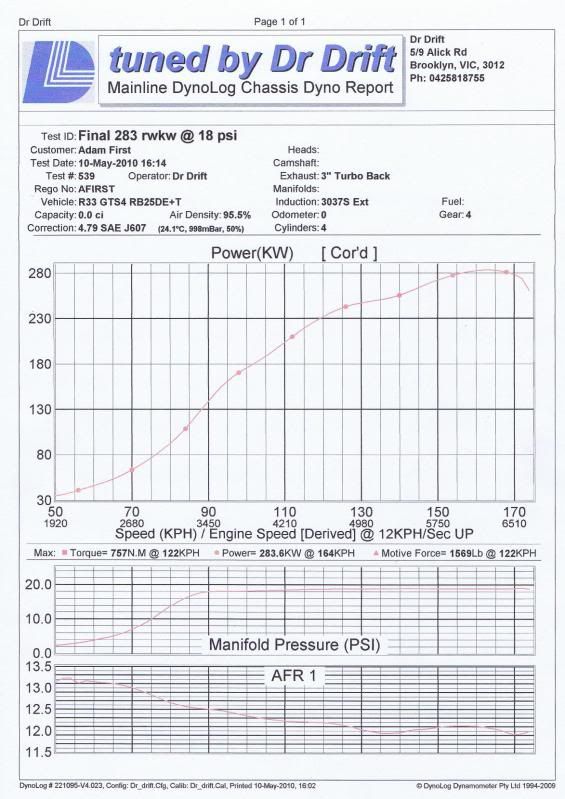

Heres my long awaited (almost) finished product:
post-36975-1273579588_thumb.jpg + post-36975-1273579744_thumb.jpg = post-36975-1273579805_thumb.jpg =
and good times :thumbsup:
We actually got it 5kw shy of 300 but wanted to make it safe as possible: @18psi this has a max knock of 20 which is nothing

nice wastegate,good work,whats 283kw in bhp and is that with standard rb25de internals and head gasket,thanks john
