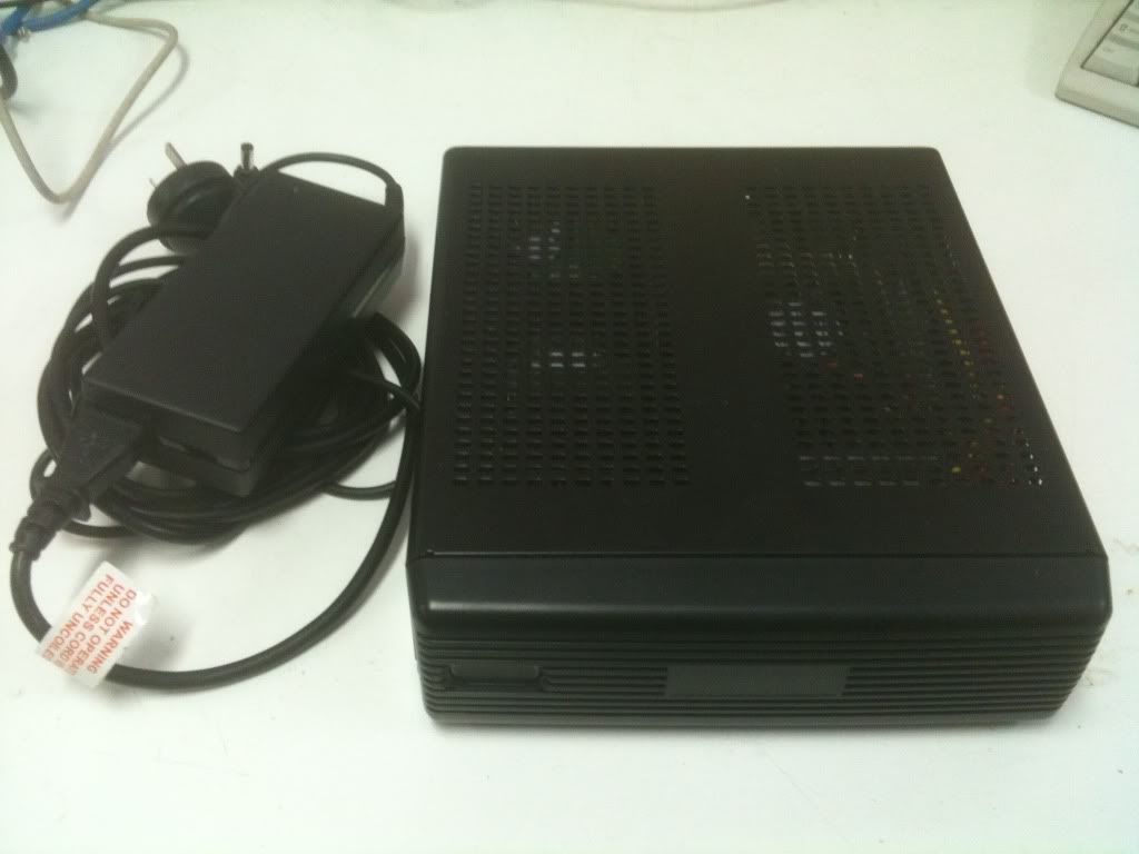

i have a Mini pc i had set up orgionaly to use for a media center at home sitting here, and i have been toying with the idea of making it into a car pc, my only concern is the start up times for the front ends... i think it would annoy me alot to have to sit and wait for the pc to start up all the time....
so i dont think it is really for me, but if someone is interested in the pc i have here... i will happily sell it off.
M330 case
Zotac ionatx-a-u (duel core 1.6ghz, 9400gt video card)
4GB RAM
320GB HDD
board has built in wifi, hdmi optical and spdif auidio outs.... if any one is intersted in it pm me XD (need cash to pay for some wheels hahaha)
