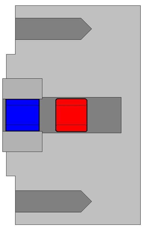

The Red is the current bush that is worn a bit and is stuck further back in the crank, it wont come out because its bigger than the insert that its meant to sit on. The Blue is where I think its meant to go but once you manage to get it into this section its been compressed so much that the input shaft wont fit into it. Is the bush meant to fit in the blue spot or the red spot?
In the red spot it is loose in the crank, in the blue spot its vft.
The only thing I can think of is to leave the old one in as its only going to spin freely on the tip of the input shaft (if the shaft even goes that far into the crank) and machine the outside of the new bush down so it will fit in the crank without compressing.

My dilemma was similar. Apparently my RB30 originally was attached to an auto trans because it did not have a bushing. It did have a larger one fitted into the crank.
This larger piece inner diameter almost looked like the smaller bushing would press in.
The larger bushing does not fit snug around the input shaft of my RB25 transmission. My thought is to just leave it off and go with the smaller one only. On =premo='s picture, the area above the blue looks like the bush I removed.
Mine must have been an auto because the crank end looks the same as your picture. Today I fixed the problem however.

So I wasted a lot of time Saturday making the bush fit where it isn't meant to go. Dammit, why couldn't someone just tell me it fits back further in the crank. In fact I could have just reused the bush that was already in the crank instead of replacing it.
I always replace the spigot bush everytime the gearbox comes out.. an old one isn't going to break anything but MY GOD the squeeling is horrible when they dry out and catch on the shaft!
Maybe if you'd taken a photo, we could have told you that you had to remove the steel auto bush first ;)
