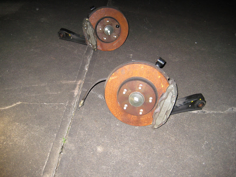

S14/15 OEM hubs and bearings assembly (generally comes attached to uprights with LCA's) –
IMG_0562.JPGFrom Phillipses blog
From what I've found, the most common of all, and the path that I chose. OEM products mean you know that they work as they are used on production cars, I bought my hubs already bolted into the s14/15 upright assembly complete with LCA's, rotors and calipers. All I had to do was bolt the assembly into my rails and struts with the help of some custom sleeves. The custom sleeves are required to attach the uprights to the stut mounting holes. Reason being, S14/15 upright mounting holes have a 14mm diameter, whereas S13/RPS13 strut mounting holes are 12mm in Diameter, these sleeves ensure that there is no free play in the uprights once mounted onto the strut. Note that using S14/15 uprights and LCA's although convenient will increase your track by a total of 10mm over both front wheels, which will mean some horrible toe out after install. This means that you will need a major wheel alignment immediately after the install and your car will handle differently afterwards (less understeer). Some people may find this undesirable. In the case of having S14/15 uprights without LCA's, you can opt to have new ball joins (R33 GTS-T ball joins to be exact) pressed into your existing LCA's to fit the S14/15 LCA's as they are a different size. I've heard from a few knowledged people and a performance shop employee that this method can come across some reliability issues, and it is best to stick with the S14/15 LCA's despite the slight increase in track.

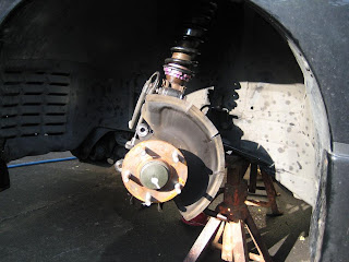

IMG_0546.JPGFrom Phillipses blog
IMG_0541.JPGFrom Phillipses blog
Begin first by chocking the rear wheels with bricks and jacking the front end up with a good jack underneath the crossmember, using car stands, settle the front end onto the stands making contact with the rails and proceed on to remove both wheels. Then continue by removing the old caliper off the upright by unbolting it from behind. There's two bolts holding it very firmly in place. WD40 or similar penetrating solvent works wonders.

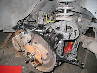

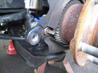

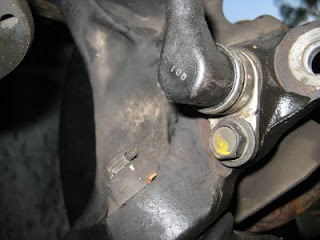

If your car is equipped with ABS like mine, you will be required to disconnect the ABS sensor, this is identified by the thick insulating wire that leads from the chassis much like the brake line and joins the sensor into the upright and is screwed into place by a 10mm hex screw. This may take a bit of fidgeting as the sensor is pressed in tight, be patient and keep working at it, it'll come out. I worked the sensor out just enough to wedfge a flathead screwdriver in between the sensor and upright and gently but firmly pried the unit out that way.
http://2.bp.blogspot.com/_bnMJJH0sZbM/SZ7P...2_instr.JPGFrom Phillipses blog
After the ABS sensor has come out, proceed to unbolt the control arms from the assembly marked above in yellow. The steering rack balljoint is held in by a cotter pin so make sure to undo that before undoing the nut. Even after the nut is undone, the balljoint might not fall out freely so you may need to tap the end of the ball joint with a hammer, remember to place a nut over the first few threads so you'll be hammering tht nut, not the balljoint to avoid damaging the thread. The castor rods and sway bars undo quite simply from nuts tightened to the bottom side. After the control arms are free, free upright from the strut by undoing the two bolts highlighted in pink, using an the rattle gun. Make sure you have a crate or some kind of support under the assembly to support it after it is unbolted as it's quite heavy. Next unbolt the lower control arm from the chassis highlighted in green, I couldn't get the rattle gun in there so I used a breaker bar instead. Once the lower control arm is free, remove the assembly and put it aside.

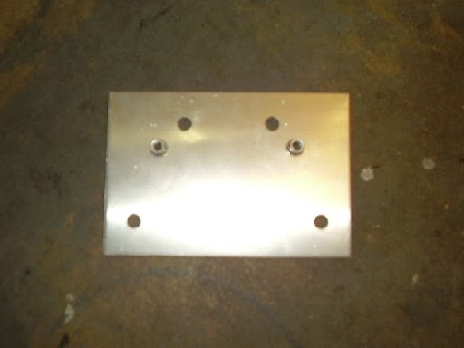

For those who are planning to go any R33 GTS-T caliper or larger, you will need to cut a set of grooves into the dish of the bash plate and bend the dish out to make a flat pan as shown above. This is so that the rotors can fit without fouling on the bash plate. Use a hacksaw or suitable cutting tool to cut into the wall of the plate to at least the depth of the pan, from there, use pliers to bend the plate out. Fit the larger rotor and ensure that there is enough room to avoid fouling.

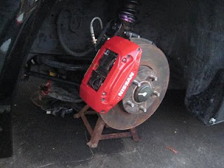

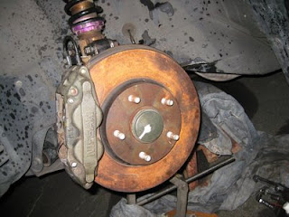

At this point, install your new rotor onto the hub, fit the caliper over the rotor and bolt it securely into the upright. Remember to use the right caliper, LHS for passenger side and RHS for drivers side. The nipple must always face the bottom. Connect the brake hose mid section to the strut using the brake hose clips, and connect the ends of the hose to the caliper and chassis hardline.
http://1.bp.blogspot.com/_bnMJJH0sZbM/SZ7S...MG_1082.JPGFrom Phillipses blog
Next, line up your 5 stud rims and tighten them up... Repeat the process for the other side... Lower the car and voila! Time to move onto the rears. Do NOT drive the car as there is now air in the brake lines and the car will not be able to brake effectively.

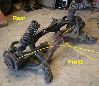

The rears are a fair bit more difficult to install than the fronts... This is mainly thanks to the complex drum handbrake assembly. What we are trying to achieve is a retrofit of the skyline drum handbrake assembly and 5 stud hub onto the S13 uprights.
http://4.bp.blogspot.com/_bnMJJH0sZbM/SZ9J...5_instr.JPGFrom Phillipses blog

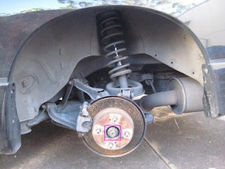

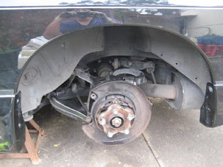

Start off by chocking the front wheels with bricks and jacking the rear end up with a good jack from the diff, remember to use car stands underneath the rails to hold the car up while working. Having done that, remove the wheels.
http://1.bp.blogspot.com/_bnMJJH0sZbM/SZ9B...MG_0225.JPGFrom Phillipses blog

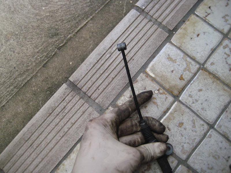

Using a 10mm long barrel socket and wrench/driver, loosen the handbrake cable. This is done from the inside cabin, the handbrake tightening nut is located on the handbrake lever. Pull the handbrake lever up until you spot the circular cutout on the base of the handbrake lever cover highlighted above in yellow, the handbrake tightening nut is located in there, place the long barrel socket into the cutout and loosen the nut until there if there is no more tension in the handbrake when engaging or disengaging, leave the handbrake disengaged. Having loosened the handbrake, get underneath the car and place yourself underneath the tailshaft. Look up to the floorplan directly above the tailshaft and you will notice the handbrake cables that connect the calipers to a T-piece that looks like the image below.

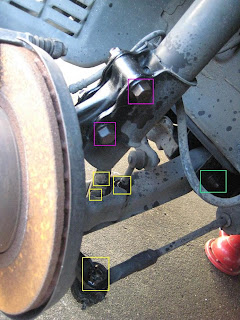

Disconnect the the brake hose by using a flare nut spanner to undo the flare nut found on the opposite side of the bracket marked above in yellow. Once this is done, remove the caliper and place it aside. The rotor can then be removed, if the rotor seems stuck onto the hub, try tapping the hat gently with a hammer, or alternatively you can screw in an appropriate sized screw into the screwhole located on the hat which will pry the rotor off the hub. Be sure to use the correct size screw, you don't want the screw threading, becoming stuck or snapping while doing this.
Undo the cottor pin and bearing lock nut cover highlighted above in pink. This will reveal the bearing lock nut which must also be removed. There's a few ways to take care of this nut if it's really siezed. I found that a rattle gun works best however if using a breaker bar, you may find that the axle will rotate under the force of the breaker bar even if the car is in gear. In this case, remove the centre cap from the wheel, fix the wheel onto the hub, drop the car, place the socket into the wheel's centre cap hole and try breaking the nut like this. I've heard of some cases where the nut is so siezed that people will even lean the breaker bar against the ground, start the car up and drive along using the weight of the car to break the nut. This sounds clever enough however I've never had to do it myself. In this case the car will need to move forward to break the driver side nut and in move in reverse to break the passenger side nut. Remember, WD40 and similar penetrants work wonders.
http://3.bp.blogspot.com/_bnMJJH0sZbM/SZ9J...s320/01.jpgFrom Phillipses blog

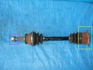

Next, unbolt the half shaft from the diff end, this is highlighted above in yellow. This will require getting under the diff and using 2 14mm spanners. There are 2 variants of half shaft in s13's the 5 bolt and the 6 bolt, however they use the same sized nuts and bolts. Once the bolts are removed, move the shaft so that it is no longer pressing up against the diff.
http://2.bp.blogspot.com/_bnMJJH0sZbM/SZ9P...4_instr.JPGFrom Phillipses blog

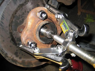

Slide the half shaft out of the hub assembly. This is often easier said than done as quite often due to corrosion, wear and tear, grit and grime the shaft finds itself quite happily seized, use WD40 generously and if need be screw the bearing lock nut a few threads deep onto the shaft and tap the nut with a soft hammer. Alternatively, what I did was use an 8" 3 claw gear puller which made the job a cinch.
http://4.bp.blogspot.com/_bnMJJH0sZbM/SZ9R...4_instr.JPGFrom Phillipses blog

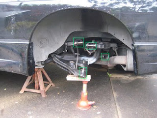

Now it's time to remove the upright and hub assembly. This is done by unbolting all the connection points that hold the upright in place. Place a support unerneath the lower control arm and proceed to unbolt the uprights from the traction, control, toe, strut and lower control arms. These are indicated by the green highlights above. Please note that in the above image, the strut is missing however it serves as one connection point. The lower control arm connection point is a balljoint type and as a result is fixed on by a nut and cotter pin, the cotter pin must be removed before the nut can be undone. The balljoint may be stuck tight onto the upright, in that case, screw the nut onto the balljoint thread a few threads deep and tap the nut with a soft head hammer. When the connection points are all disconnected, take the upright and hub assembly, and place it on a work area like below.
http://3.bp.blogspot.com/_bnMJJH0sZbM/SZ9S...2_instr.JPGFrom Phillipses blog
http://4.bp.blogspot.com/_bnMJJH0sZbM/SZ9W...1_instr.JPGFrom Phillipses blog
http://2.bp.blogspot.com/_bnMJJH0sZbM/SZ9W...4_instr.JPGFrom Phillipses blog
http://4.bp.blogspot.com/_bnMJJH0sZbM/SZ9X...5_instr.JPGFrom Phillipses blog

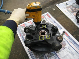

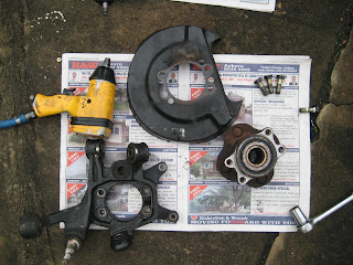

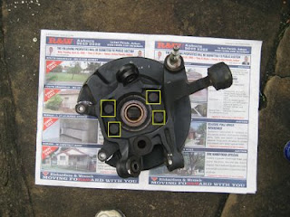

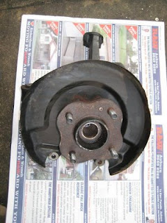

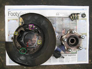

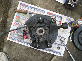

Turn the assembly so that the upright is facing up, use a rattle gun to undo the 4 bolts highlighted above in yellow, these bolts are tight and due to being on a rotatable hub assembly would not be removed any other way. Once the bolts are removed, separate the assembly as shown above.
http://1.bp.blogspot.com/_bnMJJH0sZbM/SZ9Z...7_instr.JPGFrom Phillipses blog
http://2.bp.blogspot.com/_bnMJJH0sZbM/SZ9Y...0_instr.JPGFrom Phillipses blog

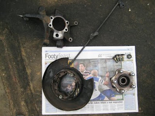

Now it's time to do the same but with the Skyline unit. Note how this unit has the handbrake cable connected connected into the baffle plate whereas the s13 handbrake cable was connected to the caliper? This is the defining difference between the handbrake function between the two classes. Also note that there is one extra nut on the skyline unit that will need to be removed, this is highlighted above in yellow. Once the nuts and bolts have been removed, separate the assembly as shown above.
http://1.bp.blogspot.com/_bnMJJH0sZbM/SZ9b...MG_0450.JPGFrom Phillipses blog
http://lh5.ggpht.com/_bnMJJH0sZbM/SZ68XzDL...MG_0449.JPGFrom Phillipses blog
http://3.bp.blogspot.com/_bnMJJH0sZbM/SZ9c...9_instr.JPGFrom Phillipses blog

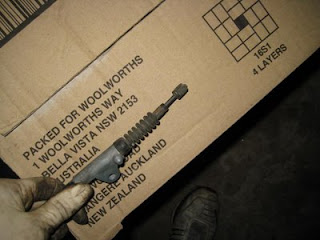

Now it's time to swap the handbrake cables. The reason why the R32 handbrake cable must be swapped with the R33 unit is due to the design of the terminals. The R32 unit will not connect up to the S13 T-piece however, the R33 terminal will. Note the difference between the terminals on the two units above. The first terminal is the R32 and the second terminal is the R33. Start by first undoing the screw on the back of the unit that holds the handbrake cable to the baffle plate, then using the above image as reference, use a flat head screwdriver to rotate the screws highleted in yello 90 degrees, they are spring preloaded and will pop out. Next unclip the 2 spring hooks from the anchor highlighted in pink, with these items unclipped, the drum brake unit should slip out with a bit of fidgeting, however will still be connected to the handbrake cable. Note the red arrow, this indicates the handbrake cable anchor point, simply unclip the R32 handbrake from this anchor point and replace with the R33 handbrake cable. After the cable has been replaced, piece back the drum handbrake by going through the last steps in reverse
NOTE: Use the RHS R33 cable for the LHS assembly and vice versa theLHS R33 cable for the RHS assembly. This will be explained.
http://4.bp.blogspot.com/_bnMJJH0sZbM/SZ9f...MG_0447.JPGFrom Phillipses blog

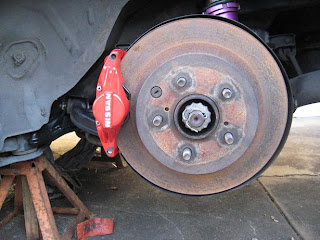

Install the new rotor onto the hub,observe how the rotor fits, is it clearing the drum handbrake assembly? Is it fouling against it? Remove the rotor and using a flat head screw driver, adjust the spline circled in green above to increase/decrease the preset of the drum handbrake. Adjust so that the rotor hat will fit snugly over the drum handbrake with a bit of fidgeting, then loosen it 2 more clicks. Put the rotor back on. Fit the Skyline caliper over the rotor, bolting it tightly into place. Connect the brake hoses between the caliper and brake hardline located on the bracket where the S13 hose used to connect. Screw the bearing lock nut tightly back into place, insert the lock nut cover and secure by threading a cotter pin through the hole in the spline. The 5 stud rims can be bolted back on at this point
NOTE: Use the left caliper for the passenger side and right caliper for the driver side, the bleed nipple should be at the top.

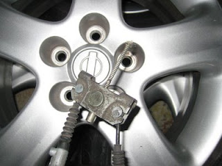

Now onto feeding the handbrake cables to connect onto the T-piece. The above image explains why the LHS handbrake cable must be used on the RHS and vice versa. The R33 handbrake cables have a little more length to them than the S13 handbrake cables, thus if the lines were not criss-crossed as shown, there would be too much slack in the line which will cause the line to foul against the tail shaft and/or the rims. The lines need to be fixed where the pink X's indicate, the brackets on the R33 lines will be a little off so will need to be loosened with pliars and relocated so as to have an even amount of slack along the line.
http://lh3.ggpht.com/_bnMJJH0sZbM/SZ681LXQ...mc/1777.JPGFrom Phillipses blog
Affix the eagle adaptor with 2 screws in the screw holes underneath the car along the floor plan above the tailshaft where the previous s13 handbrake cables used to be fixed near the T-piece. That is, where the s13 cables used to be screwed into, screw the eagle adaptor instead. The two bottom holes should line up perfectly. The other holes should face towards the front of the car. Note that the nuts on the eagle adaptor should face upwards towards the chassis, thus what you see from underneath should be completely flat. Next, screw the R33 handbrake cables to the eagle adapator remembering the lines need to criss cross after the rear subframe. After this has been done, check to make sure that the slack along the line is even and not fouling against any moving part, in particular the tailshaft, half shafts, rims, rotors or calipers.

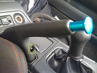

Tighten the handbrake up using a 10mm long barrel socket and driver, the tightening nut is located on the handbrake cable and is accessed via the cutout indicated above in yellow. The handbrake should be tightened until it feels as it did with the old S13 setup or set as desired.
http://3.bp.blogspot.com/_bnMJJH0sZbM/SZ92...MG_1081.JPGFrom Phillipses blog

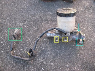

Brake Master Cylinder (BMC)
The purpose of upgrading the BMC is to increase the pedal firmness under braking after a brake upgrade. Without upgrading the BMC after a significant brake upgrade, it is possible for the brake pedal to to hit the floor before 100% braking efficiency is acheived. ABS model BMC's must be used with ABS equipped vehicles likewise non ABS model BMC's must be used with car's not equipped with ABS. Note that my car had come equipped with a BM50 which is the same model as the R32GTR ABS model, meaning I didn't need to upgrade. If this is your case, then you also can retain your BMC.

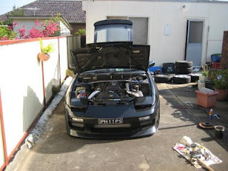

Start by opening your bonnet, the BMC is located on the firewall where the steering wheel is located.
http://1.bp.blogspot.com/_bnMJJH0sZbM/SZ97...4_instr.JPGFrom Phillipses blog
Unclip the power cable highlighted in green, and using a flare nut spanner, unscrew the flare nuts from the threads marked in yellow. Be careful as flare nuts are very easy to round off. Unbolt the BMC from the firewall via the bolts that yu will find where the blue markers are. Reverse the process to install the new BMC.
