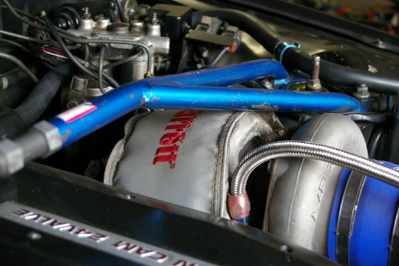

I've been contemplating with the idea of a beanie but have also heard mixed opinions on them "for" & "against"
Running a high mount set up the beanie is a nice easy way of helping engine temps and also budget compared to getting my manifold sent away and coated. Im going to wrap my dump pipe and obviously make up a new heat shield but still wondering if its worth running a beanie or not and also interested to hear others opinions???
Cheers Ben
I ended up buying a beanie from hp in a box.....and I've gotta say I'm impressed with the quality and fitment of the product. Most of the beanies I see look like a bloody silver nappy wrapped around the housing but the hp in a box item was a much nicer item.
Had it on when the car was being dyno and it certainly helped temps.
I'll post up a picture when I get the chance.

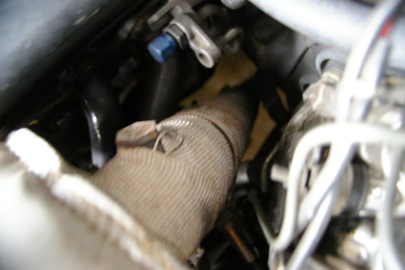

My turbo s2k was on the dyno yesterday to bed in the rings and I had a chance to measure the heat in the exhaust side with an IR heat gun. It was on the dyno for hours so this really simulated hot track condition.
I used to have a beanie on the Turbo but did not think I need it since all of my exhaust side was ceramic heat coated. The pipe to my wastegate was not coated and is heat wrapped though.
Anyway the result was amazing. The wrap is more effective than the heat coating. It was roughly 40 C lower. Could have been the good Tomei wrap I used. The whole manifold was glowing red hot during most of the initial run. It reached 500C at some stage during the tune. No wonder why the mainifold wrap never last as long as people like.
If I have to do it again I would heat wrap rather than coat. Many coating places don't recommend coating + wrap because the wrap traps the heat and the heat wears off the paint. I am putting my turbo beanie back on, will fabricate some more heat shield and may be add an air duct to the exhaust manifold.

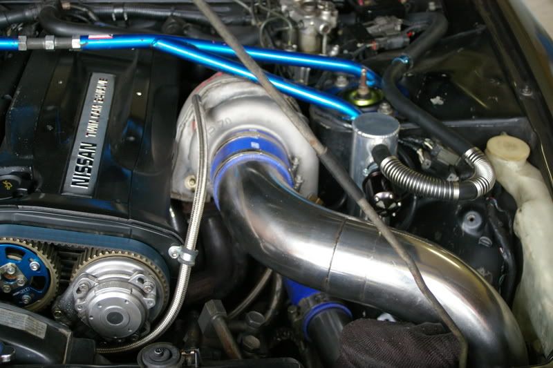

The place was called Competition and Industrial Coatings in Perth. Cant remember cost off the top of my head. They do the inside and outside of the manifold (and ex housing) in a double layer coat of the black extreme coating.
Here's an example of their work:
Man that engine bay is awesome-nice work mate.
