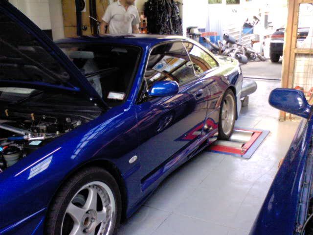

Oh just an update on my car, added tomei cams and gears and modified the twin turbo pipe... made 310kw @ wheels :P all on factory turbos and injectors. They are pretty much maxed out of course, but very good response from factory turbos boosting 1bar below 3000rpm... makes me sorta turn away at the idea of so called "response" 2530 turbos when it comes to my next engine mods.... seen some charts and it needs extra 1500-2000 rpm to get 1bar... same goes for power, up to 5000rpm factory turbos make more power...
Yes, I've sourced info from Powerplay about an increase in power from modifying the twin turbo pipe.

Oh just an update on my car, added tomei cams and gears and modified the twin turbo pipe... made 310kw @ wheels :down: all on factory turbos and injectors.
FYI there is no way your making 310rwkw on stock turbos, and untouched injectors (without a FPR etc) the limit is around 270-280rwkw for both turbos and injectors without FPR.
So whoever tuned it etc is having you on big time unfortunately, as some places like to do.
Check the RB26 Dyno results thread if you dont believe me :)
Either that or you have aftermarket turbos

LOL, thats nice... perhaps you know alot to say something like "there is no way" instead of just enquiring to get more info.... The GTR.CO.UK guys never have questioned that power level for the mods... neither has infamos RIPS in NZ. Have you heard of ST HITEC? He is pretty much 'the' guy here in Auckland to take GTRs to. He done most of the work on my car. Dispite NZs low number in GTRs, everytime i go there he has atleast 2 GTRs hes working on. Also has had 2-3 R35 GTRs there already. He does a blog and tunes alot of cars. Even had a Lambo diablo V12... haha, but only made 250kw @ wheels.
I dont think the numbers are wrong at all, becuase the cars he tunes aswell as GTRs (EVOs, STIs, S2000) produce and corresponds to numbers that other people are reporting based on the mods. FYI, Speed magazine which i prefer over fast4s etc... had an article a few years back comparing EVO7, STI, and R34 GTR doing basic mods, all exhaust and ECU and the 34 made 271kw @ wheels. Funny enough, i made 270kw. Since then, ive done Apexi power filter in factory air box, modified the twin turbo outlet pipe (dyno proved in UK and in NZ to make 4-5kw @ wheels on factory setup) and added Tomei PonCams and adjustable tomei gears. Clutch never slipped at 270, and started to on my next stage of mods, so ended up having to get a NISMO twin plate with NISMO lightened flywheel etc...
An R33 GTR in the UK that has exactly the same mods as me is also making a tad over 300kw @ wheels with the above setup (using R34 turbos)....
Check his site out, interesting reading... if u dont mind the broken english haha.

You cannot compare UK either btw, the dyno's are different and they also scale different.
Cams do not increase power when a turbo cannot flow anymore. Not sure who told you otherwise.
But then, if its a HUB dyno, then that explains when its reading high as its NOT @ the wheels at all. :P
Believe what you want at the end of the day, you'll never have the MPH to backup that power, and that at the end of the day cannot be adjusted by a computer.

I know all dynos are different, goes without saying, but thats a pathetic excuse in trying to back up your stuck idea.
Yes a rolling dyno vs a hub dyno.... i know the hub will show more in most cases. However a hub dyno is far more accurate as most people accept and some even going as far as to say "real" dyno. With the rolling dyno there are too many variables to consider and even your alignment of ur wheels to wheel weight, slip etc....
At the above tuning shop that i take my GTR to, they had a factory R35 GTR making 297kw @ wheels. (or HUB should i say...) which equates to pretty much what most guys on rolling dynos are getting and is in line with what the engine should be making too. (Funny thing is, guys on rolling dynos are posting higher figures than this hub figure for standard GTRs and yet to see a lower figure than 297kw....)
Also, how do you explain that aussie GTR making "271kw @ wheels" on power FC and exhaust in SPEED mag? Perhaps they were also using hub dyno???? Whatever the case, it is commonly and widely accepted as "wheel" figure. That power is exactly what i made on same boost levels with the same mods. Yeah the turbos rated at a certain HP and cannot flow more... so just because of this fact are you telling me an engine cannot make any more power whatsoever beyond that? After my second stage of mods, it ran on EXACTLY same boost levels, spiking up to 1.3 before settling to 1.25. There is more power everywhere across the entire rev range peaking at 310kw. But according to you that is impossible if the same size turbos are flowing the same boost it CANNOT make any more power?

So you are using a Hub dyno?
If so - please do not claim 310kw @ the wheels, because it is NOT at the wheels.
Now we've established your talking HUB - then its probably more closer to 260-270rwkw which would be perfectly normal for stock turbos/injectors.
Please ensure you use the correct terms, or people with knowledge of things will question it.
And just to reiterate - HUB is not AT the wheels.
As for a magazine - do you believe everything you read? Honestly?
Also, i hope you see some sense and back the boost off down to 1bar, because if your turbo's fail, its highly likely to cost you a motor, as many before you have suffered when a turbo fails when running too hot with ceramic turbines
