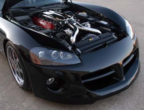

That's a nice job, looks mint. Keen to hear it on full noise.
There's not a battery backup for an alarm siren or something that's somehow hot to the 12V rail?
