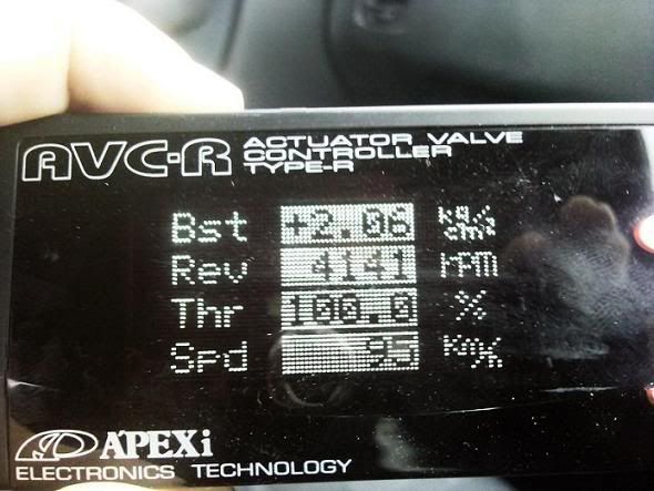

go SS2 with the external hanging off the turbo.. I get full noise around 4100rpm in 3rd and it's on E85.. it is a touch bigger.. I would say 3076R size, but a touch more responsive.

Whats full boost? 4100rpm in 3rd sounds less responsive than a GT3076R if anything
Yeah that is definitely laggier than a GT3076R - not bad for the price, that they seem to make similar power and the fact that they are a journal bearing turbo... goes well when you add up the costs of buying and installing one :) I look forward to experiencing it in person though and seeing what they're all about!
Yep, I'm probably the last person you need to tell that to :) I never ran 20psi deliberately so admittedly I can't quote exactly what I ran there but used to hit ~1.1bar around 3700rpm in 3rd quite happily so I doubt it is any worse.

Also I do have my gain set conservatively on the EBC - I find on the track it does like to spike a little thus my boost might seem a touch laggier.
I know I can get 1bar around 3500~3700rpm - just can't remember exact numbers...another thing to factor in E85 will make turbos a little lazier as the EGTs are lower but highly doubt it's noticeable lol
