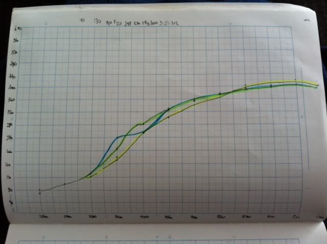

Just put hi-lighter over it. Forgive how rough it is etc.
Yellow is original 315 result
Blue is 307 ex gate
Green is new one with .82 rear
Maybe Stao can get proper comparison sheet when he try's next wheel
Thats with all of them running about 22psi yeh?
I think the new setup internally gated has the nicest curve
Didn't check boost actually But they are all final results so yeah around that. Too hard searching around on my phone to do it properly
But new one runs 82 housing not 63 so should be cooler on track. yet response is still on par.
Further updates. This is the 2nd SS2 prototype been trailed. More responsive and made more power to previous version. Internally gated.
Max of 312rwkws on BP 98 and 210rwkws by 4000RPMs
22psi by 3750RPMs, 20psi by 3650 RPMs:

Max of 348rwkws on E85, probably another 15kws in it as my fuel pump is out.
I believe this turbo would make a pretty responsive 250~280rwkws internally gated on a stock manifold on pump with around 18psi of boost. Would go crazy to run on external gate and e85.
