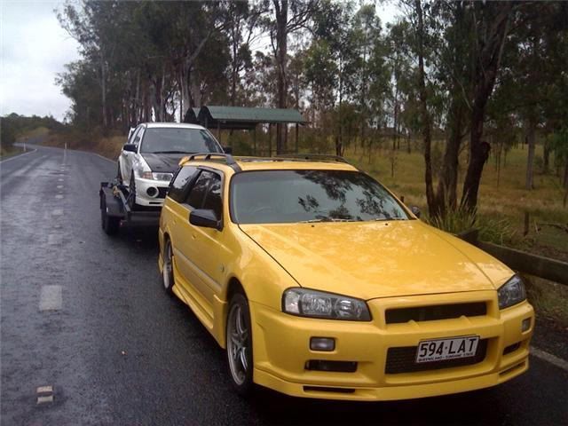

Well since your car is a manual, you won't have to worry about a shift-kit or bigger trans cooler...
You will probably want to upgrade the springs and shocks at some stage, but apart from that it should be a non-issue. Perhaps except some slightly 'tougher' brake pads?
Duncan regularly uses his Stagea to tow his GT-R race car, and EvoMitchy uses his to two his Lancers, so you'll have no issues.
yep i took my "lancer" :D interstate and had no dramas- just under 2 tonne and well over 3000kms round trip. I would however recommend upgraded suspension and brakes. Other than that it tows like a champion (and drinks like one too hehe)
Duncan regularly uses his Stagea to tow his GT-R race car, and EvoMitchy uses his to tow his Lancers, so you'll have no issues.
and what he said!!
They are a great tow car as long as you are ok with stopping to fill up all the time. very smooth and comfortable, plenty of power, good handling. totally unlike a crappy old foulcan really.
