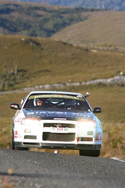

YT's old R34 we ran in 07/08 was like that cage, bloody hard work getting in/out! lol
Nothin better than pinching a nerve in your neck when getting in 3 minutes prior to a stage! lol, good strong cages but :D
Did that have the horizontal bar? I just cant seem to recall it cos there was so much room to swing your helmet back there?
Timmy, no, it didn't have a full diagonal, but rather two smaller diagonals behind each seat. They were welded about 50cm from the top and upper sides in the centre hoop.
I found a pic that kinda shows the bars....... and our intensity! lol. Just zoom in on it a bit.;
