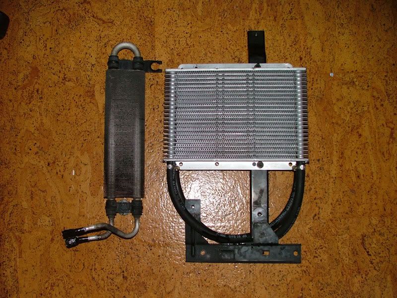

KiwiRS4T Posted August 3, 2009 Share Posted August 3, 2009 orright! it's under way!quick question, does anyone know if all s2 stageas have standard tranny coolers? All I know is the S2 has as standard one almost as big as the aftermarket one i used for the S1. See picture for small S1 on left and aftermarket on right: Link to comment https://www.sau.com.au/forums/topic/281029-aftermarket-radiators-on-s2s-c34s/#findComment-4746717 Share on other sites More sharing options...
rx7gt Posted August 3, 2009 Share Posted August 3, 2009 All I know is the S2 has as standard one almost as big as the aftermarket one i used for the S1. See picture for small S1 on left and aftermarket on right: yeah stock tran cooler not 2 bad considering so many auto cars only only use radiator type!!Most manufactures recommend upgrade of trans cooler before towing a trailer. You will find the cooling lines tee off into radiator cooler and go into stock cooler located in front of radiator left hand side. Glad to see all wheels in motion as i hate it when my stag is off road. Nice after market cooler kiwi rs4 good too see peole thinking about reliability not just power/ boost. Stag on Link to comment https://www.sau.com.au/forums/topic/281029-aftermarket-radiators-on-s2s-c34s/#findComment-4747544 Share on other sites More sharing options...
