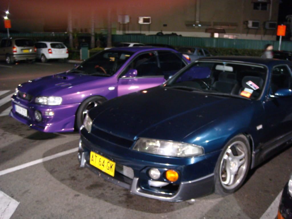

thanks guys... this is exactly the kind of info i was after...
hopefully this will stop him from puttin this rubbish on his car...
its not a bad looking car so far... id hate to see it fall apart
http://i256.photobucket.com/albums/hh197/usmair/DSC00304.jpg
