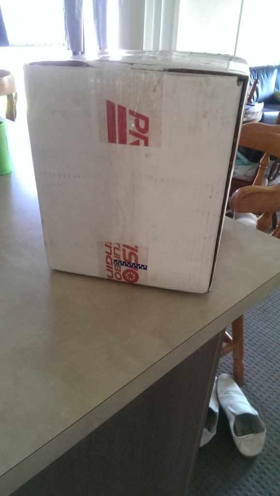

Few presents arrived yesterday which got me rather excited
It was time to unwrap the goodies...
After a quick inspection i incurred a problem..
Somewhere in the order stages of the manifold there was a mis-communication and it has a T3 flange instead of a split T4 flange that the rear housing has. I range and spoke wit hKyle from 6boost who was quite happy o help out and he said he would fab up a new manifold and send it direct to Richo at All Star Tuning so its their by Friday. I have also organised the one i have to be sent back.
